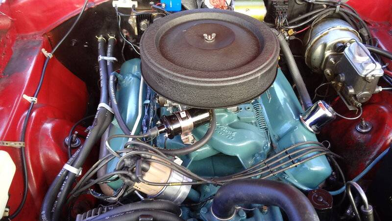

My rebuilt 383 came back to me painted with what was supposed to be Chrysler Hemi Orange, and I suppose it was close to the original shade; but I wasn't happy with the quality of the job, with places missed and some spots flaking off. I repainted, after degreasing, with Dupli-Color Gray Engine Enamel Primer With Ceramic, P/N DE1612 and Dupli-Color Chrysler Hemi Orange, P/N DE1652 -- both in spray cans. I was pleased with the result.

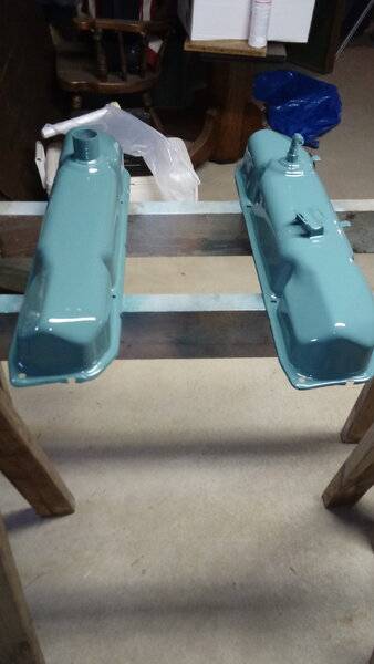

For Hemi orange. I use Dupicolor SHEDAP1690 self etching primer and spray them using Duplicolor DE1652 then clear with DE1636. They all still look good after many years of use.
