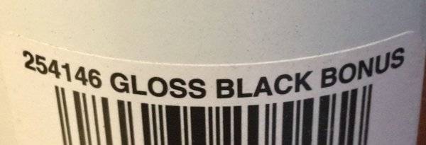

Hello, i have to paint the under body of my 1970 Dodge Charger RT. It will be a mild restomod (classic look with good track performances). The whole car is gonna be painted in black. What do you think is my best option?
One friend of mine recommended this product...
Any advice is more than welcome!

please don't use the rustoleum.......and don't let anyone talk you into por15 either
no need to go high dollar, a low end epoxy or single stage urethane would be fine
no one ever looks at the underside unless it's F'ed up, and UV rays won't be an issue
Alright! Rust-oleum seems to be an awful option...
I am not pretending to be purist, I just want the car looks great, so urethane and single color could be a good decision. What do you think? Thanks for your help!
