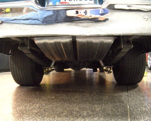

View attachment 230288Car currently has 31'' x 18.5'' - 15 Mickey Thompson Sportsman tires on it.
They seem rather large and close to the fender well. I want to change it to a full racing slick and I am unsure what size would look and work the best. Below is a picture of the car I just purchased. Car is street "legal" but it will never be driven on the street.

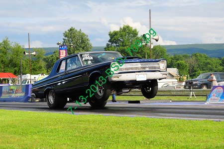

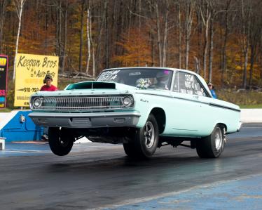

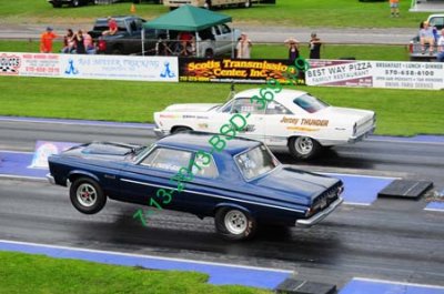

I agree because this is what I run and I have tried almost every brand slick. As Cranky said, you need to find out what size rim you have. You can run a 10" rim up to a 14" rim with these stiff sidewall slicks but I run 10" on mine and tried 12" with no issues.
They also hook insanely too

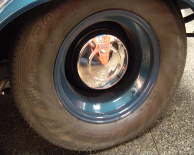

I agree w/ Daytona kid an DVW. If you watch your tire pressure and heat 'em up, I think you'll find they perform very well. I found M/T's Sportsman Pro's work well for me. As you can see, they hook well enough to "wrinkle down" at 24 lbs of pressure. Keep in mind I don't race the car however; It hooks pretty well for a ~600HP Hemi. These are 28X13.5's. I had a set of Hoosier street slicks on previously and didn't like the way they "felt". That's just me. Also, You may want to get used to the car before you change out the tires.
Good luck and keep us posted on your choice and results..

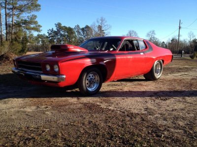

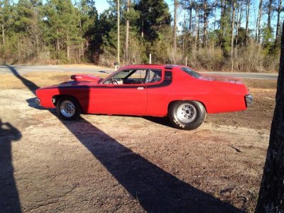

I think it looks much better now. Changed the tires to a slick and dropped the rear coil overs to a lower position. Still need to set the pinion angle. But it sits so much better now. The tires are over inflated in this pic so I think it will drop slightly when I set it to racing pressures. I think there may be 25 psi in the tires right now. 10896860_875770165792609_3890476630017970178_n.jpg10926457_875770122459280_7314971927205413635_n (1).jpg
