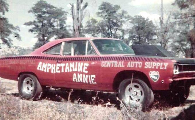

It will depend on how hot your cam is. If you have a really hot cam like I did, every time it lopes it shakes the car. I switched to a chain for a torque strap with just a bit of slack in it added to the rubber mounts. That way you have rubber cushioned mounts until you really get on it when the chain tightens. When you hammer it and the chain becomes taught, you have a solid motor mount.
I raced in the 70's and my best 1/4 mile time was 10.44 with 160 mph. I am unsure about the mph but I always had a high mph. That was with a '68 Road Runner with a 383 bored .60 over, reworked ported and polished heads, milled to far with 13 to 1 compression, tarantula manifold, Holley Dominator, cam and Hooker headers. 11" slicks and a perfectly set up suspension. I lightened to 2,690 pounds which was a key factor. I was a 4 speed with 4.30 gears in a 8 3/4 rear end and I made the 4 speed into a crash box by grinding every other gear off of the 2,3,& 4th main gears. I did not do burnouts and I did not use a line lock. 90-10 shocks in the front, air shocks rear, spring clamps on the front half of the leaf springs to make them a solid "bar", and an adjustable snubber set 1/4" from the floor pan. You have to practice incessantly on your power shifts, shifting with your feet flat on the accelerator. Start slow with your if you do power shifts because if you miss you may blow your engine. Look. This was full race, all out, but you have the choice of duplicating what works, like the suspension. If you drive it on the street the 90-10 shocks mean avoid all potholes, the 5" wide front tires mean driving slow when you turn. Lightening the car means fiberglass hood (which I made). plexiglass windows, no hood hinges, no window mechanisms, no carpet padding, no undercoating, no rear seat, no frills. My time was set at 2,350 feet above sea level, so factored at sea level, it would be lower.
160 mph was your trap speed running mid 10’s on 4:30 gears? Something doesn’t add up. I would have to see the time slip to believe 160mph.
Also, 2650lbs sounds low for what I've seen, unless the fiberglass is insanely thin and light. Uncle tony has a 4 door 72, which is a bit heavier so that adds to some of it and he is full steel but he has the thing rattling and shaking apart almost with cutting brackets and supports with removing undercoating and carpet, but he's still at 2950. He's also on a small block.
Are the 70 and earlier B bodies just that much lighter? I mean God damn 71s and up must be fat to be that much heavier with all he's removed
Couldn't imagine going down the track or street with a car that you can rattle around the front and rear bumpers with one hand and the hood is flimsy as all hell
Would be about 10.90 @120 at best on a modern timing system but who knows what the the old systems said
A 62-70 B body is far lighter than 71-74.
Doug
