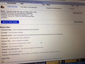

Summit shows the PRSL05 with tru-track for $2,285.97?
