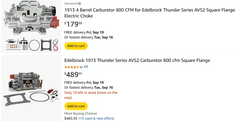

What the hell is going on here? This shows up on an Amazon search, what's the dealio with the first one? Looks wrong and no way should a new car be only $179.
It's a Chinese knock-off, the internet is full of them. Notice in the description it says " for Edelbrock Thunder Series".
This will be the legal loophole to avoid any accusations of false advertising or copyright.
DO NOT BUY. There's plenty of reviews on youtube. Everything will look similar but be slightly different. Tuning nightmare.
