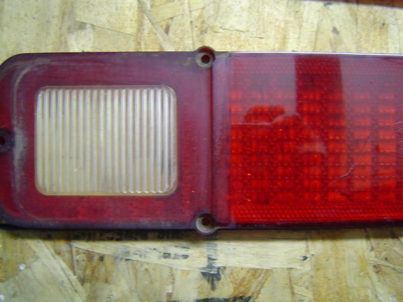

Set of tail lights rallye style. Good color not a lot of fade, no cracks or major scratches, very dirty. What's your best method / product for cleaning polishing. I've heard of finishing with a urethane coating to add shine and long term protection.
Are you talking about the lenses? If so, and not scratched or cracked, you can use some heavy duty rubbing compound, followed by light buffing compound followed by a good buff with some wax and used a low speed wheel on a drill or by hand works well. The inside was just cleaned real well with dawn dish soap.
Here is a test one I did before doing my other sets that went on the car, ignore the crack, but you can see the difference.
