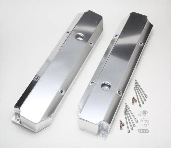

I designed my own valve covers and had a local machine shop make them for me. I used a 1/2 inch flange and have never had any leaks.

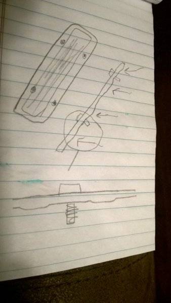

I've never needed to do anything different:
Valve cover flange has to be flat and not cracked at the areas the washer contacts them (rather common these days). Also assumes you know the holes are good and the valve cover flange isn't touching the intake manifold anywhere when it's in place without the gasket. It it does - you need to figure out if the gasket will provide enough distance to clear it AND still be compressed.
