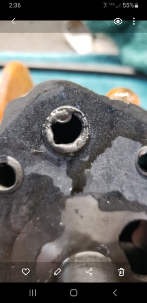

Had similar issues ..... but my engine was Dyno run .... so I thought it was ready to go. When I started it there was a delay of pressure to reach the mechanical
gauge but had good pressure. First power run ....gauge went to Zero. Shut engine off on a 4th to 3rd power shift ... got good pressure to get it back to the shop.
Yanked the oil pump and found that the builder used so much rtv that when assembled the oil pick up passage closed down about 50% or more starving the engine
under hard acceleration.
Put on a new pump. cut open filter .... no damage so far ..... 2000 miles last summer. So maybe start with the pump ..... remember I am no expert on this :rolleyes:
This is why Ma Mopar says no sealant on this gasket. Because she knows someone will put too much on. Of course any RTV that gets in that hole goes straight into your oil galleys.
