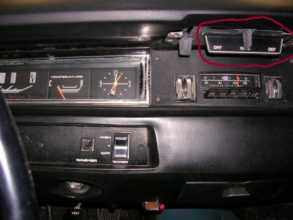

Anyone know how to seperate this bezel from the plate its mounted to, its a '69 RR.
I'm guessing it was pressed on as there is no set screw to be found...BUT , dont hold me to it...;)
If you drop the whole control plate down... it's held in the dash with 4 screws, you'll see the plastic part is held in with two pressed on clips. Carefully pop 'em off so as not to break the tabs and you're in business.
