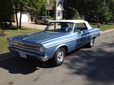

I just want a few opinions. I bought new wheels and tires last summer with radials. While they drive nice it still bugs me to look at them. My last few cars had bias ply tires-and yes they rode and handled not as well.
here is the car:
I don't drive it any farther than 2 hours to a show-farther than that I have a car trailer.
I was thinking of running 6.95-15 Silvertown blackwalls up front and a ribbed cheater slick out back.
thoughts/opinions?
