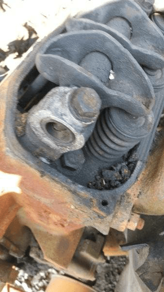

In the '63 model year there were both. Here's a pic I posted in another thread of a '63 with pedestal rockers and 6 bolt heads.
