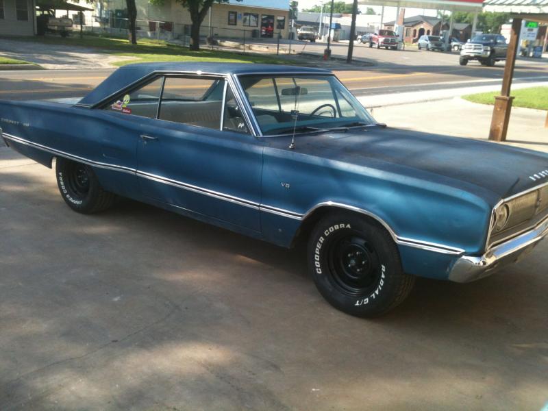

this is probably a dumb question but im a novice to this stuff, but is there a such thing as a big block 727 trans and a small block 727. and if there is what is the difference, i have a 67 coronet 318 727 trans and was looking into a big block purchase and wanted to know if my current transmission would work.

good 67 you have there...nice straight body. I looked EVERY WHeRE for one of those...before my 68
