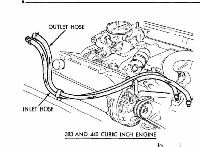

Connecting heater coolant hoses from my Big to the Heater core. I read different people say it doesn't matter but my after market (Vintage Air ) system has a water valve that has a flow direction arrow on it. With all port sizes the same I need to know the flow direction out of the block to the heater core. Can any one help?
:D Mr FS Manual say's..................
