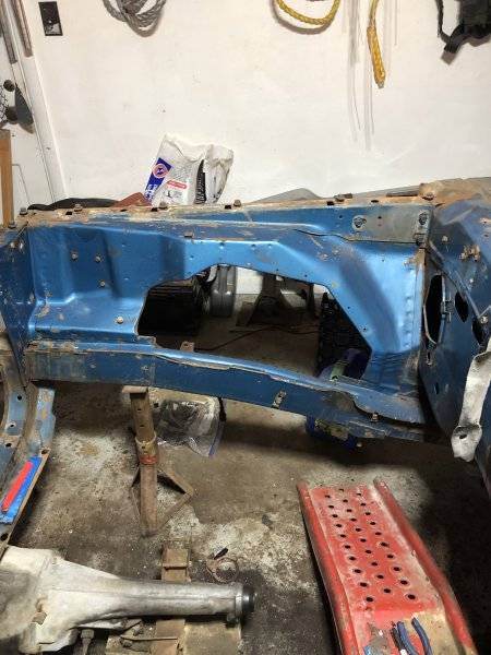

So I have a rusted out big block car and a solid small block car I want to drop the big block parts in. So far the only thing I really notice is the passenger side engine bay sheet metal is different. Does anyone know if there is anything else I need to remove sheet metal wise to install in the small block car besides the passenger engine bay wheel well? Both 74 RR, Thanks for any ideas

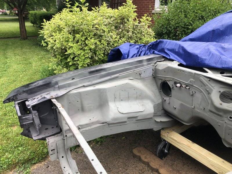

The passenger side on the engine bay has a huge hole to clear a big block where as the small block has a much smaller hole and cover. Primer car is the small block, blue is the big block car.
The radiator support looks to be the same size, wondering if there is anything else

Someone hacked a hole in the inner fender of the blue car. There are no differences between the inner fenders of a big and small block car.

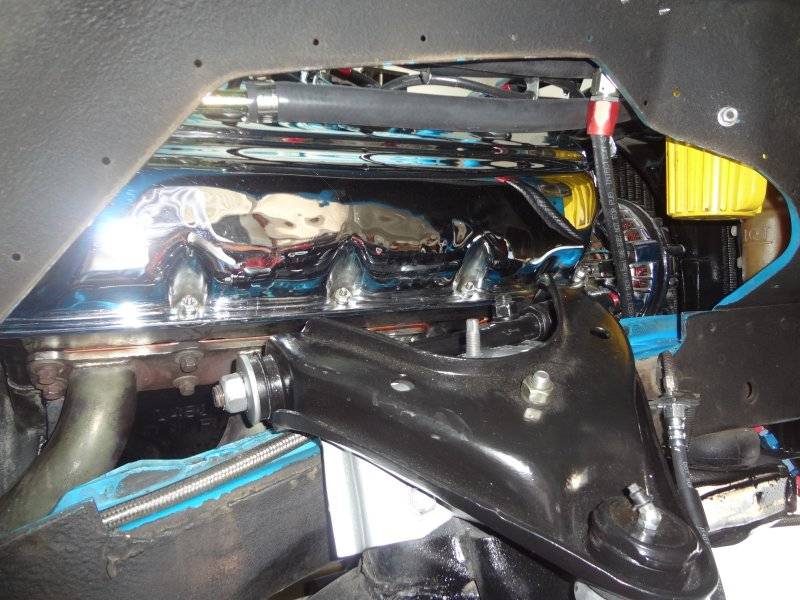

73 and 74 Big Block B Bodies had a large access hole in the passenger side inner fender from the factory and used a rubber splash shield to cover it.
Here's a picture of my 73 RR GTX as you can see the passenger side access hole from the wheel well looking towards the engine.

Everything is coming out of the big block car and going to the small block car, already have the passenger side wheel well pulled to weld into the small block car. The knowledge here is pretty good. It’s helps to have people to bounce ideas off of.

Just have to change over the one side, I have seen people put big block in small block cars but it get tight. I could just cut up the small block car but it’s cleaner to remove the spot welds and weld it back in.
