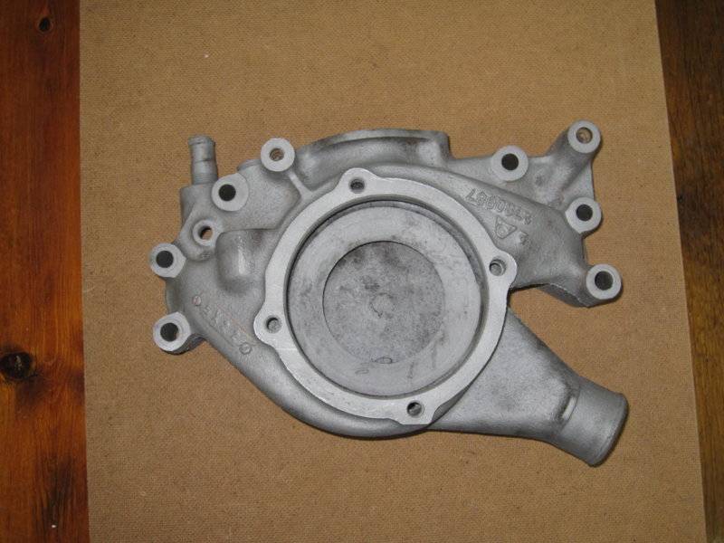

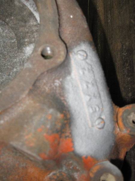

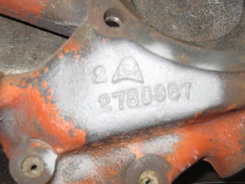

I 've got one with the correct casting number but, I don't see a casting date. Is it a code?

The water pump housing I perceived to be original to my numbers matching engine has 9 3 on it.
My engine assembly date is 9/4/1968.
According to MMC Detroit -> LINK
Two digits can mean Month and Year, or Month and Day
Month and Day would make sense so then is there no way to tell the year?
Another possible clue is my temp sensor has M8 on it. That would seem to indicate December 1968? Could have been changed out? Who knows for sure?

Would engine assembly date and casting date for the housing be the same? I would believe that the casting date should be closer to the block casting date. They both had to be machined before use.

I don't believe it would be possible to assemble any engine with a pump cast the day before. Like you mentioned, machining was necessary and logistics must enter into the process also. There is also the "human factor' to consider.

One has to look at all years of WP to see how casting variances occur over time. For instance for the 69 model year, I have noticed that there is a cast in fratzoid on the front of the face. Not on 68's, so when this change occurred takes looking at many housings. Other clue, orange paint, if original means 69 or 70 HP engine. another clue , 70's use a small pipe nipple. Another clue, is placement of the casting number, 69's and up seemed to have it on the outlet portion. Earlier ones are on driver side near pump opening. And finally later housing I seen with full month day and year cast in, earlier ones dont.
Be a scientist, look at a LOT of data before writing the policy paper.

Google failed me here. What is a “fratzoid” you refer to?

I blasted the entire pump and still couldn't find anything besides the 2 areas in my first post.

'fratzoid' should have said the Chrysler pentastar. fratzoid is the dodge triangle symbol.

The top surface under the thermostat can be belt sanded smooth and only your hairdresser would know.

Thanks for doing that Mike. What does the thermostat gasket surface look like? Sure wish 5XZZ made some sort of sense to me?
