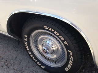

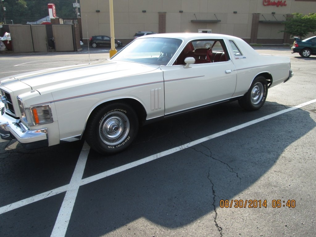

This is mine with 255/60's on all 4 corners. I don't think you can go any wider on the stock rims.
I'm running 245/60's. I used one of the conversion tables to convert the original GR60's listed on the 300 brochure
