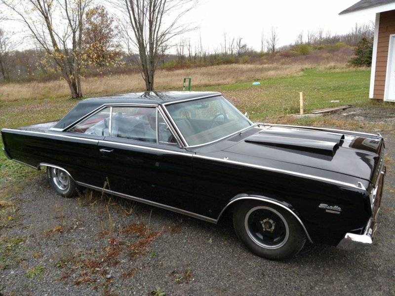

Black Beauty a 66 Satellite E-bay find
Chapter 6 - Running and Driving

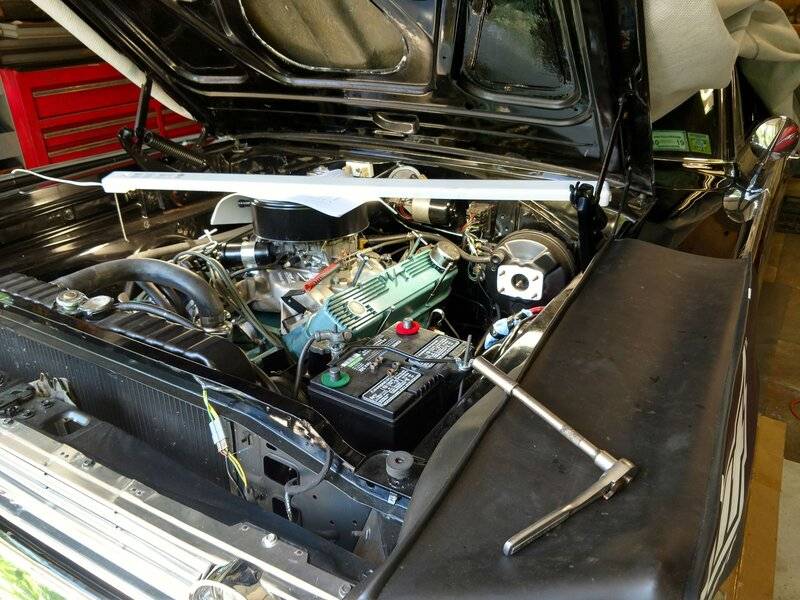

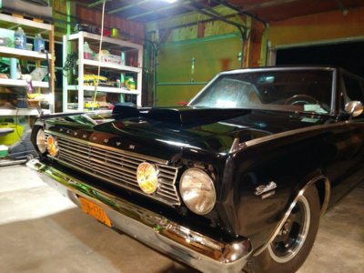

Before stashing it away for the winter my brother helped me get the hood installed.
Video of it idling one evening sometimes I will play it when I get the Winter blues.

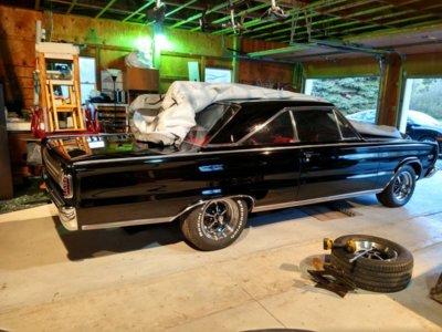

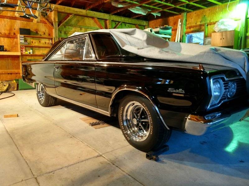

I've never bought a new set of wheels until last week. But I finally decided that since I had a decent pair of Ford 15" x 7" magnums, I would buy a pair of Wheel Vintiques Magnums from Summit. Friday evening I took the rear steel wheels and new Magnums to a friend nearby who does quite a few wheels in his shop at home.
Saturday after dinner I put them on. I kinda freaked out when I set the first wheel on and it looked like it would hit the inside lip of the fender.
But after lowering it I can pretty easily fit a thumb between the tire and inside edge of the fender lip. I like the look of the wheels, but I would prefer the rear sit a bit higher. They are 15 X 8" with 4-1/2" backspare with 245-60 tires. (Still need to clean the letters on the front tires)
I've only driven the car one day this year, another cold wet spring here in Western NY it's only 46 degrees here today with rain and drizzle all day.

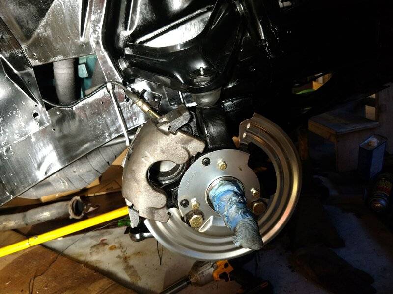

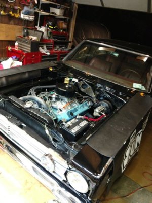

2020 Update: Front End Rebuild
Last summer was not a good one for car projects.
I travelled and worked in factories almost continuously through July before things improved.
After that I didn't want to start any big projects, just drove the cars a few times to local cruise nights.
I actually started getting parts together well over a year ago and this spring felt more motivated.

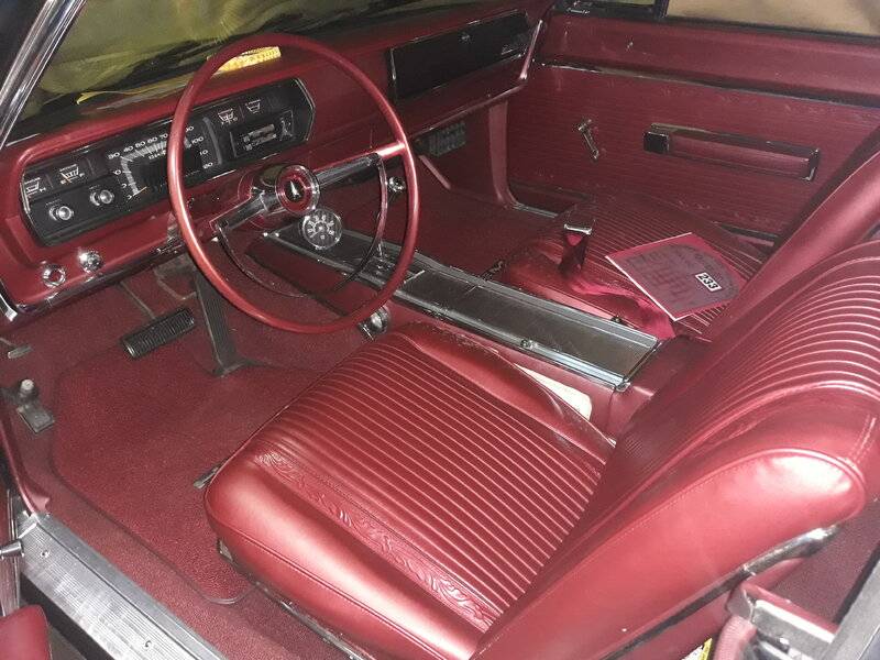

I started late winter by converting the turn signals to LED's then finally put in a radio I had bought and installed the glovebox liner.
Almost forgot I put new red carpet in it as well.

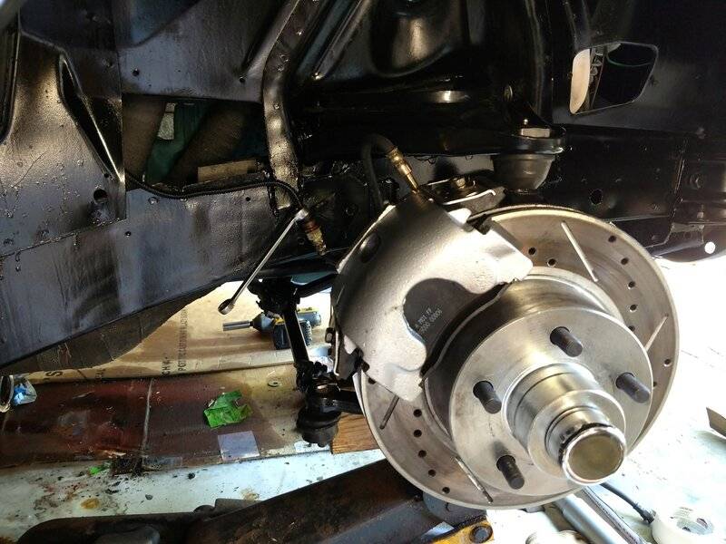

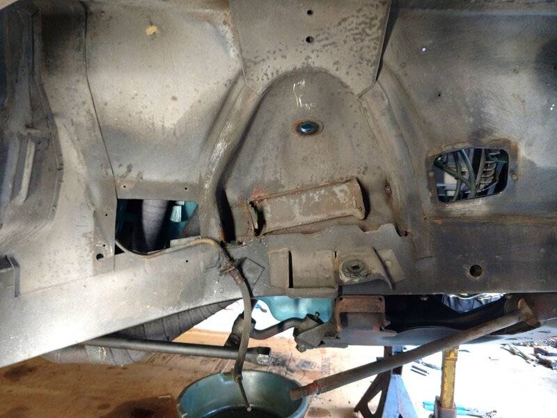

I started removing the old bushings from a set of lower control arms and a sway bar from a 67 Charger that I'd bought and my son blasted them for me. I ground off the rust on the swaybar and painted it last year.

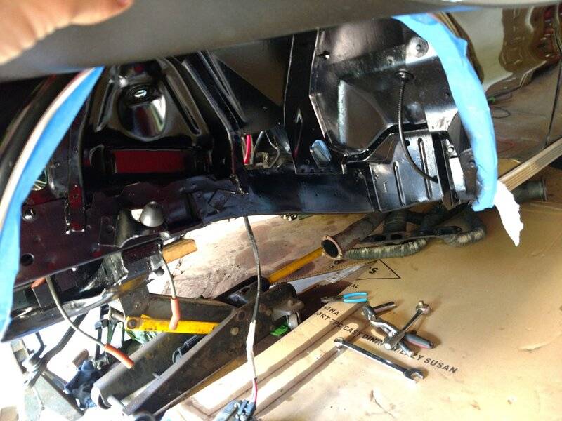

Finally I cleaned up my garage (carriage house) and backed it in tearing off the front end.
The big screw up was the sway bar mounts, my son helped weld them for me but I tried to go from memory on the orientation and ended up installing them backwards.
I wasn't really rushing on this job but all the cleaning and painting took a while.
I did spend an entire weekend towards the beginning before I installed anything.
Part of the plan was to put new wheel cylinders and replace the hose to the differential as well.
But when I pulled the first rear drum everything looked really good including riveted shoes that were pretty thick.
The wheel cylinders say "Made in USA" and look fine so I changed my mind and flushed it out with silicone fluid after installing the new rear hose.
I cleaned off part of the differential and found a "B" marking from the factory looked like new.
Another project will be to clean and paint the rear end.
I also changed out the steering box for a Steer and Gear extra firm unit.
The old one had quite a bit of lash to it but the coupler was quite tight.
Another 3 hours of removing the drivers side header, starter, jacking up the motor etc..
Next time I'm buying a new exhaust system to go with the HP manifolds I've got upstairs.

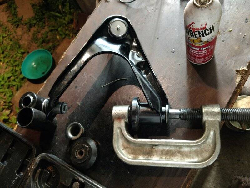

Unfortunately I found a problem with the reproduction upper control arms they looked like they would hit the upper support so I had to cut off the rear overhang.
(After they were already installed).
I also found I had a squeek when hitting bumps almost positive one of the cheap bushings is spinning in the arm.
I already had to press in a Moog bushing to replace one that was loose.
Should have known better than to use aftermarket uppers...
But it drives nicely still need to get the sway bar on it but I intend to.

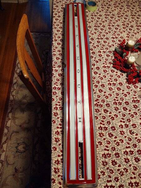

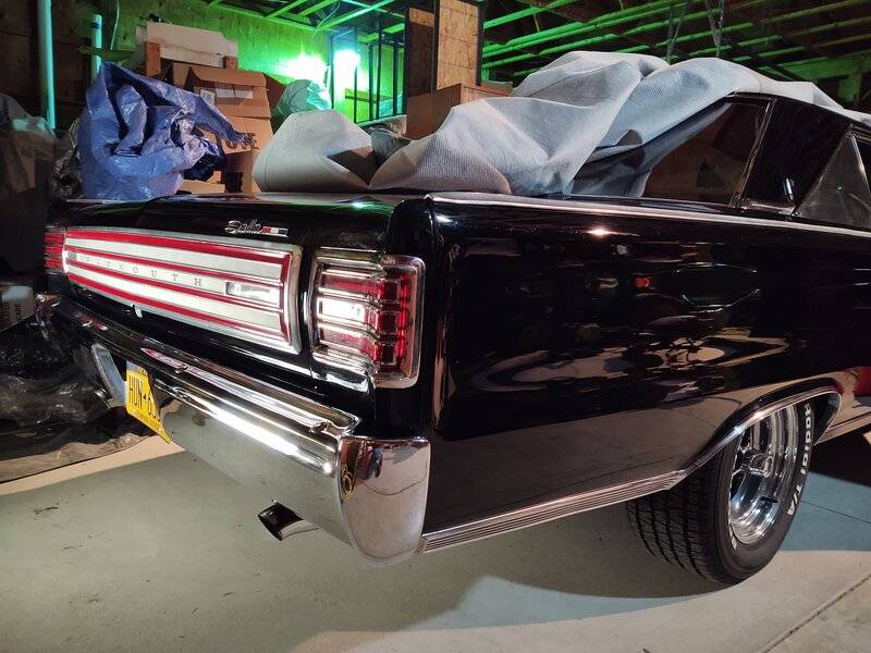

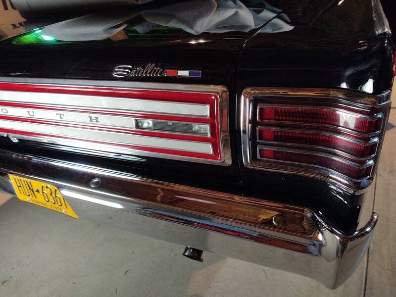

I had some time off between Christmas and New Year.
There was a thread here about the correct color for the rear trim panel on the trunklid.
Sounded like a fun little project so I found some paint masked it off and shot it in my basement.
Today I got home a little early from work and it was fairly warm so I installed it back on the car.
I'm pretty happy with the finished product. IMG_20210115_172034177.jpg IMG_20210115_171924075.jpg

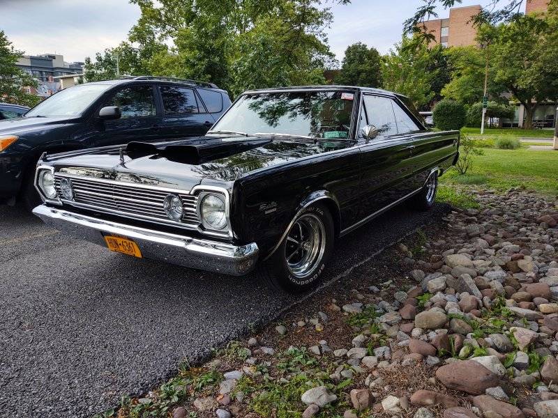

Wow, nice car! How about some current pics of the car?
I heard there were a few black with red interior 66s at Carlisle this year.
Glad to see you got this one done.

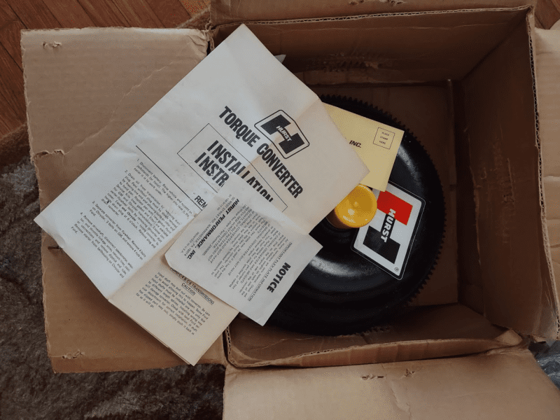

Earlier this spring I bought a NOS Hurst shotgun torque converter from @Big bill.
My friend Dave who built the transmission in my Charger gladly agreed to rebuild the transmission in the Plymouth.
