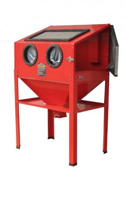

Several years ago, I acquired a blast cabinet from a certain "import tool company" that is known for inexpensive tools. Recently, I learned on another thread here (http://www.forbbodiesonly.com/moparforum/showthread.php?63721-68-Charger-build/page3) about some good upgrades for the cabinet. One being a better light setup, another being a far better gun setup, etc.

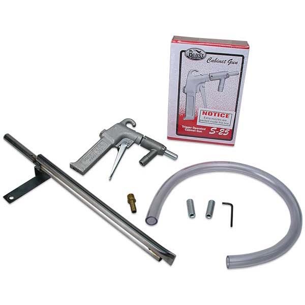

2. Gun:
Purchase a "USA Cabinet Gun & Pickup Tube Upgrade Kit." Here's the writeup from Skat:
"This is a complete made in USA Cabinet Gun Kit made to replace the operating system of most imported sandblasting cabinets on legs. It gives you the benefit of USA blasting technology at an economical price. It also provides continual and immediate availability of nozzles and wear items as needed. Includes clear instructions and installs in minutes with simple hand tools. In addition, our complete catalog is included for future availability of parts and nozzles."
http://www.tptools.com/USA-Cabinet-Gun-and-Pickup-Tube-Upgrade-Kit,2320.html?b=d*8026

This leads me to questions about the window you look through to see the piece you are blasting...
I ran out of the tear-off sheets that go on the inside of the plexy-glass to protect it from blasting. Has anyone found a source for tear-off sheets? Maybe there is a better way to deal with the issue entirely? What have you done?
...Wait, wait a minute... I found a source for tear-off sheets (or "inner lens protectors" as this site calls them). Just measure your plexy size and pick up the size/quantity you desire:
http://www.tptools.com/Cabinet-Inner-Lens-Protectors.html
Still, is there another site or method of dealing with this issue? Would real glass perform any better than plexy?
