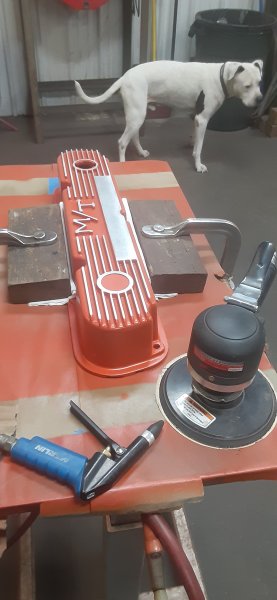

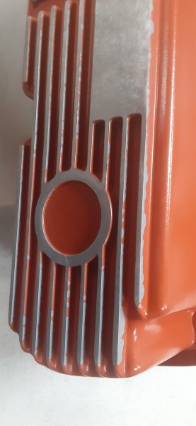

Like the title says I know little to nothing about painting, most of my experience comes out of a rattle can. You can see in the pic what I'm going for. I just want a bright aluminum look not polished. I have decal the print shop made for the large flat area then a few coats of clear.

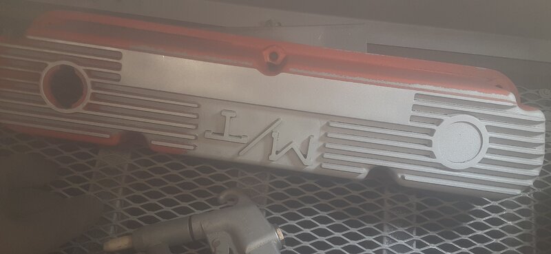

I painted painted the V-covers with a coat of self etching primer then 4 coats of Dupli-Color engine enamel with ceramic. This was a couple 3 weeks ago. Came to the shop today to get in some personal work while the sun was shinning and get home before 11++ pm. I thought all was going well till it wasn't. Started the sanding with 120 then 220 then final with 320. Notice on the first one the paint chipping/flaking off at the edges. Thought maybe the 320 was to aggressive to start so, I started the second one with 220 then the 320. Same thing.
What do I need to do to remedy this. Should I put them in the blast cabinet and start over with a different paint. Or, can I just use the same paint and do the sanding while it's a little soft not a 3-4 week cure time. Thanks for any advice.
Maybe incompatibilty between the etching primer and enamel? Is the self etching primer still adhering to the aluminum on the edges that chipped? The duplicolor engine enamel page shows Gray Engine Primer on the primer tab.
That is how I did the block. Talked to a fella at the parts store who "claimed" to be a painter and said I should use the etching primer because it's aluminum. Again that's why I love my dogs, they don't claim to know nuttin but when it's time to eat, sleep, or s##t and if somebody's at the door.
The problem could be the etching primer, regardless of what the store employee said. I have used various etching primers over aluminum (boat stuff) and most, if not all, of the etching primers say that they are not to be top coated with paint. They need a primer, over the etching primer.
Looks like it pulled the primer, adhesion issue. Blast with glass bead. Acid etch would be best. Not sure if I would primer it, would need to scuff it before paint. I would tape it, cut excess off with an exacto or razor blade, you may have to do the paint in more than one step. That paint probably isn't the best for the job. You may get to do this more than one time, it takes mistakes and trying something different to get the results that you are happy with. You can polish or scotchbrite it after it's painted. POR 15 would be a good choice for paint.

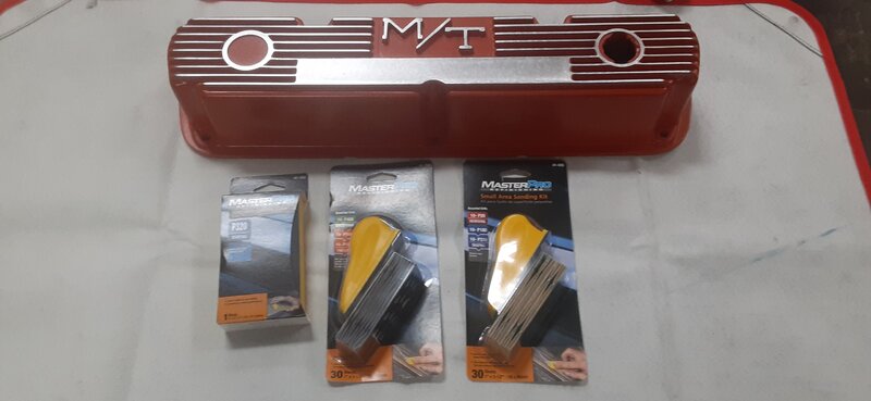

If the orange paint is flaking off while sanding it, it looks like it didn't bond properly to the valve covers. As Bird 426 said, it's an adhesion issue, you need good surface prep before painting. When you re-do it, use a sanding block instead of hand sanding so you know you'll be sanding the raised areas flat, and not have your hands/fingers dipping below into the valleys.
Both #9 and #10 work. It just takes practice, trial and error. Block sanding is good, go fine, and with water for lubricant.
Prep work - Blasted with aluminum oxide then blown off and wiped down with acetone. Painting - Etching primer applied, 1 coat. Allowed to dry then the color was sprayed in lite coats, maybe 30 min between coats. Last coat was wet to the (my) eye. Sanding was done with 6" IR orbital sander roughly 3 - 4 weeks later AKA today.

The orbital was your pitfall. As I noted earlier I would have done the sanding FIRST and wiped the top clean with lacquer thinner... but in this order the sanding should have been done with the paper wrapped around a piece of 2 x 2 wood and straight back and forth the length of the cover.
On the engine in my avatar I sanded the flat spots first so it would be easier to shave them with a razor blade after I painted them. I started shaving after an hour of drying. (Not fully dry.) All I can think of for you to do is reblast and start over. It took all day but I'm happy with the results.
There's another way, I like the razor blade idea too. All suggested here will work.
A lot of good advice and ideas, thanks. I'm going with a complete do-over. Like my ol' man said "The road to success is paved with failure". I do no not think there was an adhesion issue, as I'm having to be verry meticulous as I blast them to get complete removal. For those concerned about leftover blast media making it's way into the engine, there are no baffles in these valve covers except for at the filler and breather holes and they are removed for this process.
I believe my downfall was using a DA to sand the tops. I am going with the wet hand sanding on this attempt. I'm pretty sure that will give me the results I'm looking for. I like the idea of sanding the primer from the raised areas before moving on to the color.

Dad's bee and Kiwi are correct imo. I have done it that way many times. skip the etching primer, go with an epoxy primer, lightly sand with 400 for an even consistent surface. I have used a lacquer thinner with a damp cloth just enough to wipe clean the surface you want bare aluminum, then clear coat it. the thinner seems to help melt the very edge of the transition and seals it at that point, good luck.
