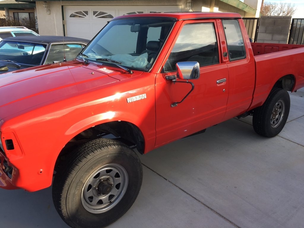

I watched that episode and I'm prepping to do that to some fender guards on a 86 Nissan 4X4 sport Truck I am restoring....
