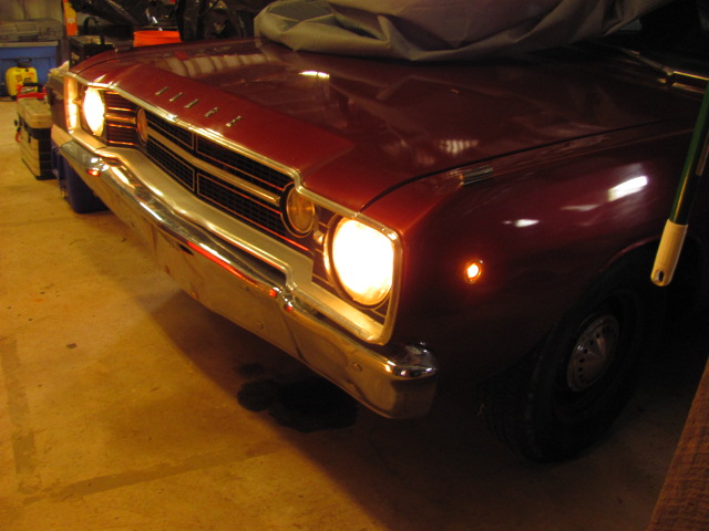

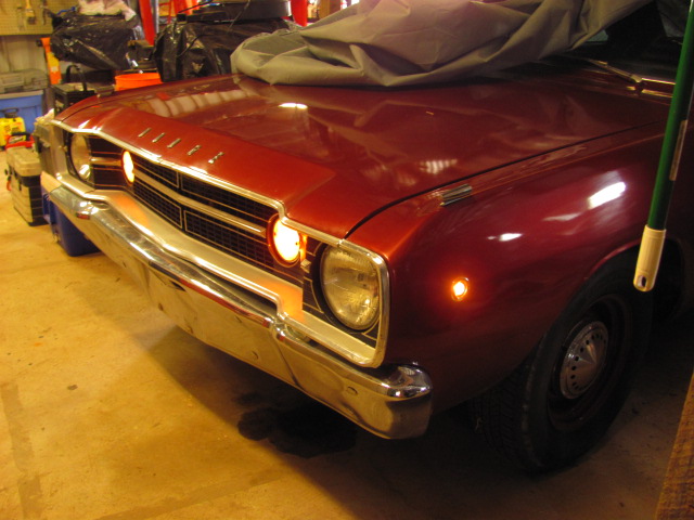

I posted wrong info above and have corrected it. Here's a couple of pics.
