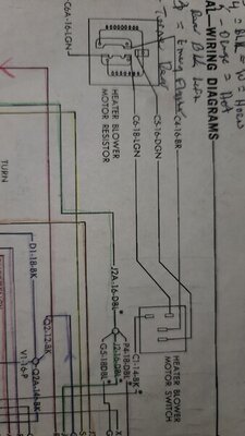

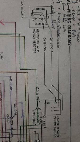

This is from a 67 schematic, should be able to look in the FSM or online to see if yours does have the resitor as well
Resistor is mounted on the outside of the heater box right under the glove box. Pull it out and check it.
When the resistor goes then the only speed on the blower motor is high.
