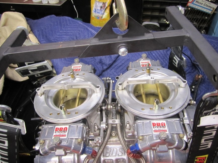

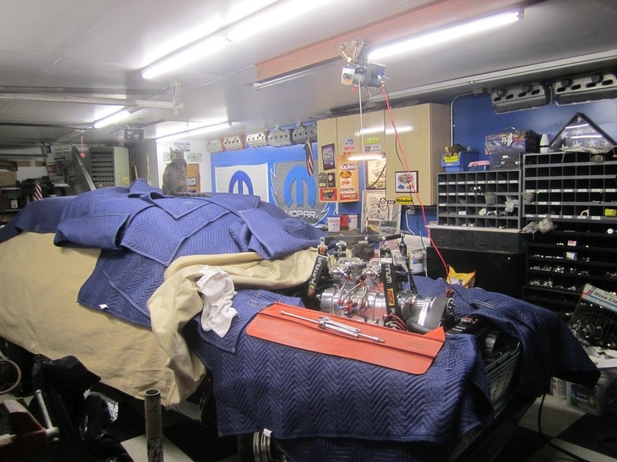

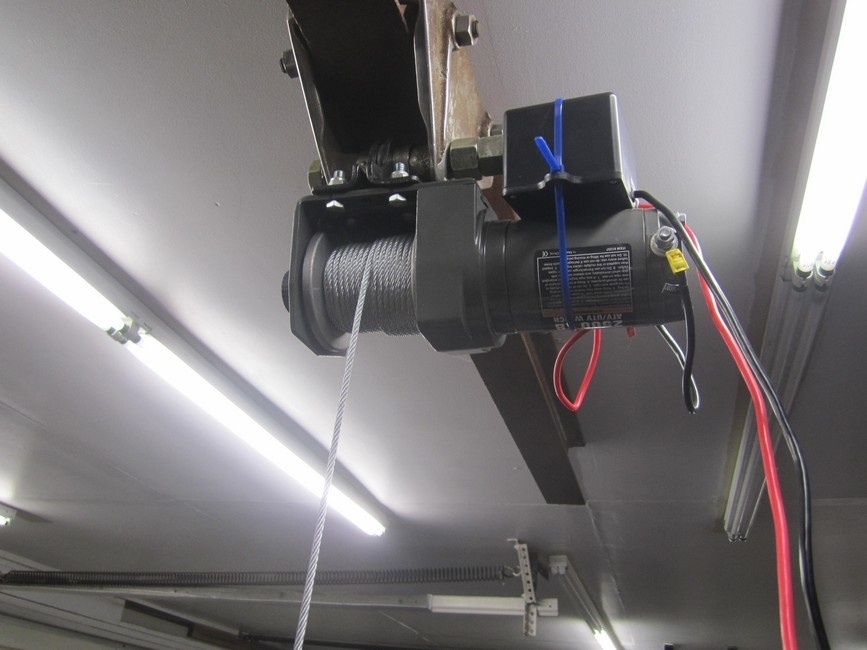

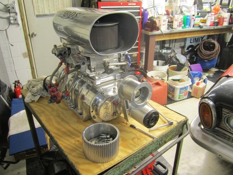

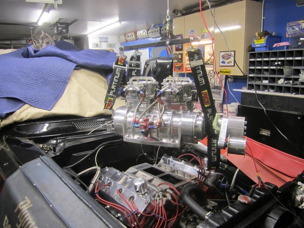

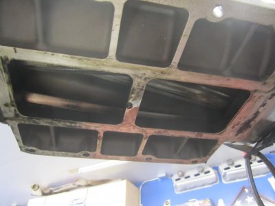

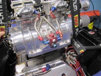

Build your shortblock right,use a decent set of heads.You don't need huge ports with boost! That 671 will be good for you to start and when and if you want to go faster,8 bolts and a fuel line and it comes right off. Then an 8 or 1071 will bolt right on. To make my life easy,I built a little picker to lift the blower off for any reason.
