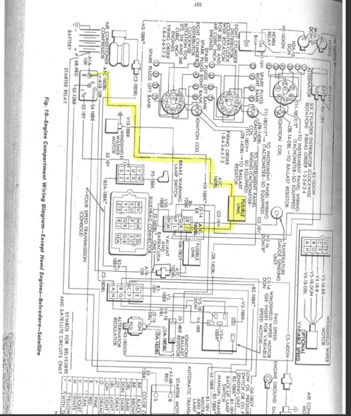

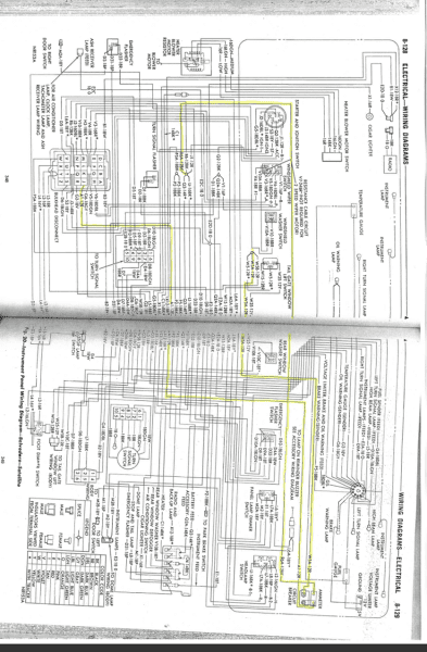

This morning when driving to work I had turned onto a rural highway and accelerated made it about 500 yards and lost all power. I was able to test and confirm the fusible link had done its job and separated internally. After looking over the wiring schematic I see a circuit breaker on the rear of the gauge cluster near the Ammeter, the ammeter leads are going to two different splices in the harness is there an area I am missing, miss reading or I something else I should be looking at? I would like to take it to a show at the end of the month but I don't want to just slap the fusible link in and hope it will fix itself. Any suggestions would be greatly appreciated. Highlighted in yellow is the Fusible Link circuit.
Sorry 1969 Plymouth GTX 440 With 727 Aftermarket Electronic Ignition 1970 Style Day 2 ignition System
There is a circuit breaker by the ammeter on convertibles and station wagons. You have a dead short to ground. I would look close at the alternator and the wires running along the valve cover.
Ok I could have a short in the engine compartment or instrument panel as well to blow the fusible link? Ok I will trace wiring on engine side check and make sure that is ok then move to dashboard, sounds good I will give that a try after work. Thanks @pnora
Ok great ignore circuit breaker on schematic. Thanks @gkent

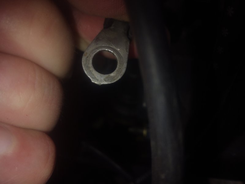

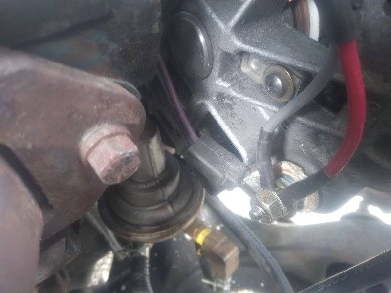

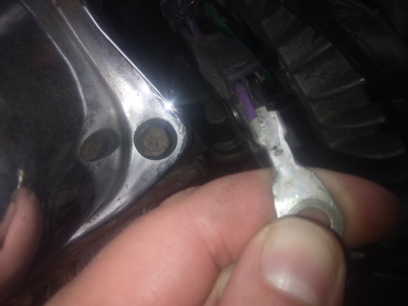

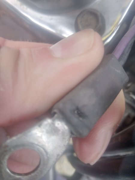

Well I found the culprit it was pure laziness... I found when I had added the light
harness on Saturday I had positioned the charging wire on the alternator incorrectly and it rubbed through the sheathing and caused a short, repositioned the wires at the 12 o'clock position and now no issues other than ordering a new fusible link, is there anywhere other than classicindustries.com and yearone.com where I can get a replacement I am good on parts for now but the shipping is ridiculous..

Thats one reason why I do not add additional items to be powered off the alternator stud.
I would still suggest some heat shrink or Dip-it on there.
Fair enough I was just fighting low alternator charge on the one wire system but i see the issue now for sure.
Rock-Auto sells fusible links under tools and universal parts>electrical>Fuse>Fusible Link
I will probably add that before i add in the replacement fusible link, have you made your own with wire before is that recommended i hear not all 16 gauge fusible links are not the same, is that true?
