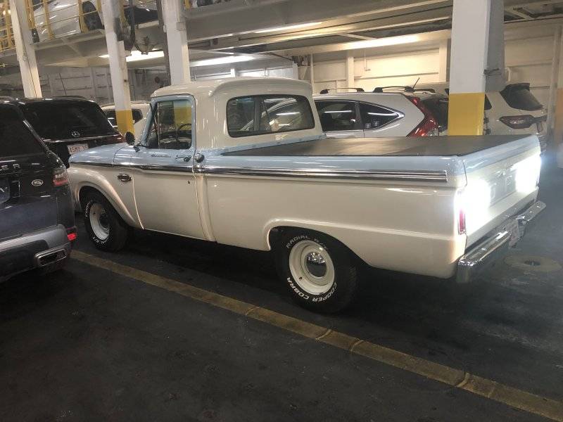

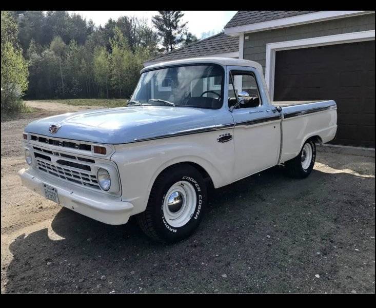

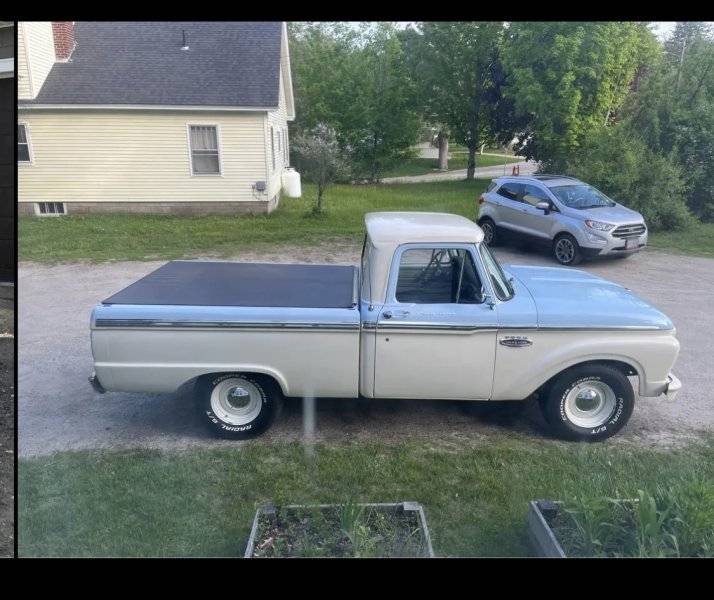

A little stop off at the Oriellys to buy a fire extinguisher and fuel filter. Then to the ferry.. My brother-in-law piloted the GMC CHASE vehicle….then home
Not yet. Needs a serious tuneup. Starts with tap of the key and idles smooth as silk, but it’s breaking up under load. It got better after fuel filter change and can if seafoam in the tank but still not right.So...... does it do righteous burnouts or what?
THAT is GORGEOUS! Congratulations.I'm not getting rid of my Charger but I saw this and could not pass on it.
Picking up this weekend.
I see a lot of those trucks with small block Chevy engines in them.There's one on You Tube with a Hellcat swap. I bet the Ford guys don't appreciate that.

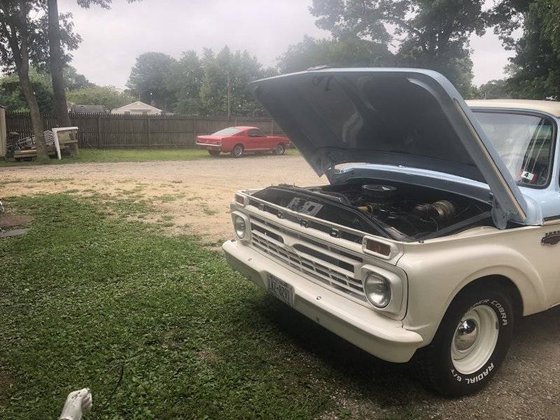

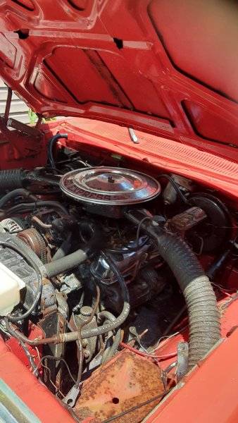

It looks to have an Edelbrock 1407 on it. I’m pretty sure this is a smogger 460. It’s still wearing its OE cast iron intake and exhaust manifolds. Today was a total whirlwind. I’m going to really dig in tomorrow.
Spent the whole day on it. Running better. It’s not winning any drag races but it’s pretty good. It has the eddy 1406 on it, not the 1407, so it’s def not overcarbed. Found a small vacuum leak which I took care of by tightening one of the carb nits which was hand tight.LOL, well they were all pretty well smoggers, unless you lucked out and got a late 60's "thunderjet".
If you want to patch it up on the cheap, cruise the net for a second hand aluminum intake and some decent shape "Dove-C" (D0VEC) heads. The dove heads are the thunderjet heads that had 10.8(or something close to that) compression. Adding those to even something as abysmal as a 74 engine will bump ratio up to 8.9 or into the 9's, plus almost as big of ports as a CJ head. Shorty headers and retune the carb and it will be a totally new animal. Not wild, but more then the original equip truck suspension can tame in any case.
Have fun! That truck already is a real head turner and I am sure it sounds mean even if it is pretty tame yet![]()
