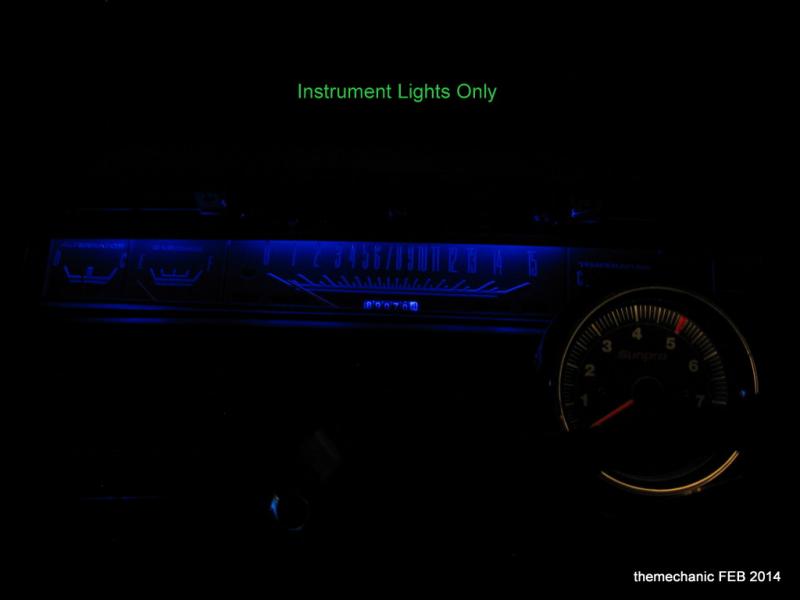

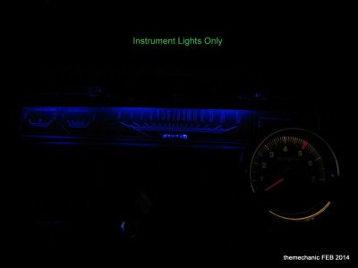

If you are talking about instrument panel lighting, you don't need the blue domes if you use blue LED bulbs. That's what I did.
For your application check http://www.superbrightleds.com/ then see if you can buy them locally.
Can a guy just replace the bulbs or are there other parts needed to do the switch?
You should probably remove the blue plastic domes if you want to use LEDs. They fit the bulb sockets. However, I found out if one doesn't light when you plug it in just pull it out, turn it 180 degrees and plug it back in and it should work,
Another consideration is some LEDs are forward facing only which are good for turn signals and warning lights. But for the dash lights that light the gauges you should use LEDs that are omnidirectional. Look at Superbrightleds site and you will see the bulbs I am referring to.
