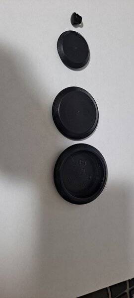

We have always in the past just sold a generic kit to cover the 66 to 70 B-Body and 67 to 72 A-Body door frame plugs. Just wanting to create a more specific kit for the various applications as I see it as unnecessary to sell you something that you will never need. With that said, looking at a junk door that I have here for a 66 Plymouth Satellite two door hardtop, it appears that each door used two of the 7/8 inch raised dome plugs and one of the 1/4 inch raised dome plugs as well. Just want to confirm that as being correct for the 67 applications as well. The 68 to 70 B-Body applications will use one of the 1/4 inch raised dome plug, three of the 7/8 inch raised dome plugs and one of the 1-1/2 inch recessed plugs.
As memory serves me, the 62 to 65 B-Body applications uses one of the 7/8 inch nickel plated plugs for each door, is that correct? Can anyone tell me if the 71 to 74 B-Bodies used the body plugs as well for the doors?
funny you should ask this question as I was just searching for the caplugs for the door of my 68 RR! Looks like they use 4 each of 3/4 and 2 each 7/8 inch, and then larger for holes in the bottom of the door. That would be for 2 doors.
