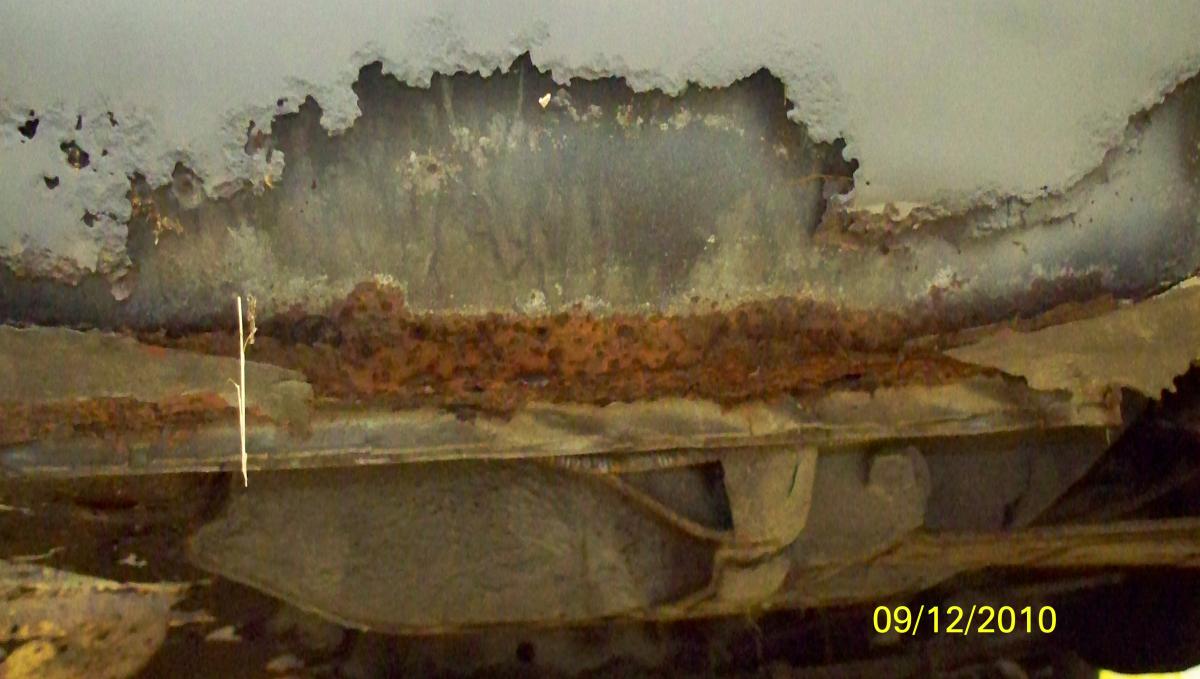

Wow, hell of a project Kevin, we'll help you out anyway we can. You will want to brace this one off pretty well because I'm thinking you are going to remove the floorpan and replace that torsion bar crossmember and be fixing the inner rockers simultaniously. Is this a post coupe car or a hardtop?.
