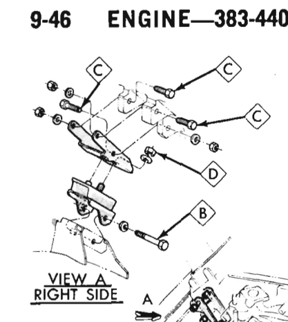

It's the long bolt that connects the mount with the K-member, bolt B in below picture.
The nut for that bolt is welded on the metal plate of the mount.
On the old mount they probably stripped the threads in the past and drilled it out to fit a metric bolt through the hole and secure it with a separate lock nut.
I want to fit it like it should be but have to get some UNC bolts, the threads on this nut is course thread for sure.
The brackets that are connected on the engine are still as from factory and do not have nuts or so welded.
