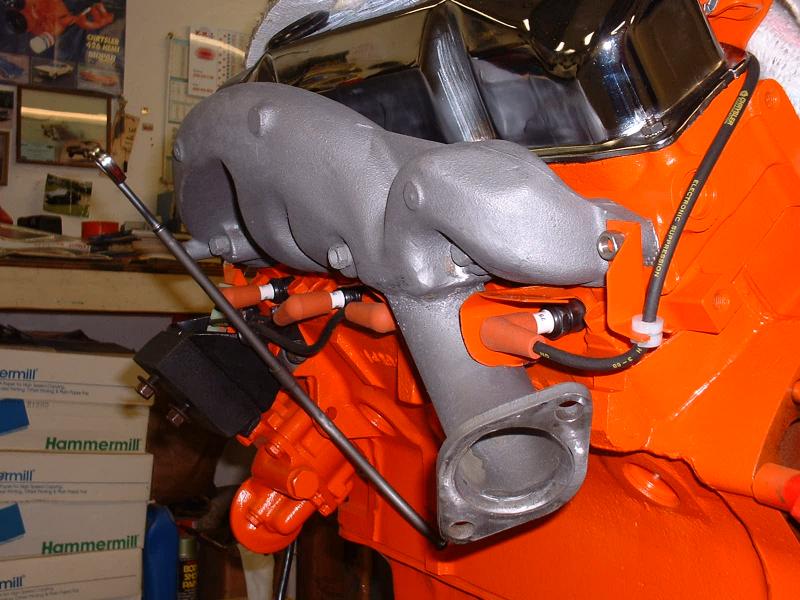

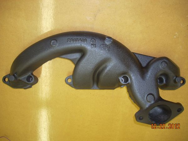

OK, this may be a stupid question, but here goes...
I removed the old C-body exhaust manifolds from my 70 Road Runner with a 383. There are currently studs in place at each location. I am now in the process of bolting up correct HP exhaust manifolds, but they have deep well holes in some spots that swallow the stud. There is not enough room to put a socket down in the hole.
Do the stock exhaust manifolds use bolts rather than studs in some locations? What is the proper method to fasten them at these "deep well" location?

(The below attached pictures are not my application, but give the general idea.)
Did it have the 'log' style manifolds before? If so, that may be the problem. IIRC, the log style has a thinner head flange. Compare them to what you have now. If they are the same, get a longer stud.
The deep holes take the long barrel nuts as stated above. All the studs in your heads should be fine.

Looks like he has the long barrel nuts on it but it's the end studs that are not long enough......??
The problem is that I don't have the long barrel nuts. These are what I was unaware of, and I am missing.
I will have to check the length of the studs, but hopefully they are OK...
Thanks for the help! This solves my dilemma - it was just lack of knowledge for what was needed. Unfortunately, these are not available at a local hardware store, so I will have to order them...
Yeah, but even so, the wrong length stud is still on #7.....
Cranky, sorry for any confusion. These were a couple of quick pictures I found via an internet search. I was just trying to show the deep holes in one picture and the other picture I thought was a long bolt of some kind. The link showing the long barrel nuts was the "holy grail" information that I needed.
