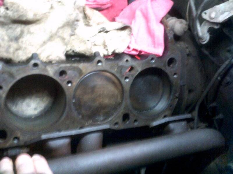

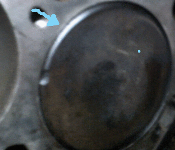

I have come across a 383 4bbl engine from 1969, "E" on the Id pad, that look to be untouched (stock bore, steel shim head gasket, plastic timing gears) and noticed the "notch" on the pistons is at the back of cylinder bore(toward rear of engine) and FSM claims it should face toward the front. (as most rebuilt engines have)
I know an old hot rod trick to flip the piston around for reduced friction, its even in the old Direct Connect/Mopar performance B/RB manual.
But from the factory?
So photos of unmolested engines will help.
Here is one pic.
My 1969 383 4bbl has notch in correct spot, as the FSM says it should be.

Pistons on both sides of the block are the same and oriented the same. Think of it not as toward/away from the center of the engine but front/rear and direction of rotation. The connecting rods differ of course left to right. Notches always forward for stock, reversed for that old Direct Connection trick.
