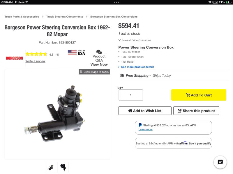

Anybody running this box?
The kit comes with the coupler. Does that mean I don’t have to cut the steering shaft?I think you will also need a bergman coupler as well if you don't wan't to cut the steering shaft.
What he said plus Peter supplies you with the needed fittings.If you buy the kit from BAC, you don't need to cut the shaft.

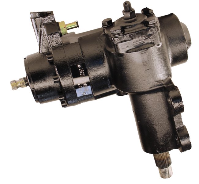

Thats what I put in my wagon recently. Direct bolt in, clears oe exhaust. However...if you have headers, which I do, you have to do some thumping. For my 67 w/440 and Hedmans, #3 & #5 had to get thumped some.FYI, there are more options to look into. Lares has new gearboxes 11033 & 11043. 11043 is a firm feel 2.5 turns lock to lock. You'll have to buy the pressure fitting to go with it, part# 177. Rock Auto has them for $398 & $467.

Did you ask him about a black Friday deal, I think he usually offers free shipping around this time.I just got off the phone with Bergeson. They are going to hook me up with everything I need to hook up to my flaming river tilt steering. No cutting required. I got the kit with the pump and hoses as well as a cooler. I also got the kevlar brake shoes and SS PTFE coated brake lines as well as a polished Leeds master cylinder and booster.
It says free shipping on his website.Did you ask him about a black Friday deal, I think he usually offers free shipping around this time.
Awesome, that’s a good deal for how heavy it is. Congratulations you’ll love it.It says free shipping on his website.
