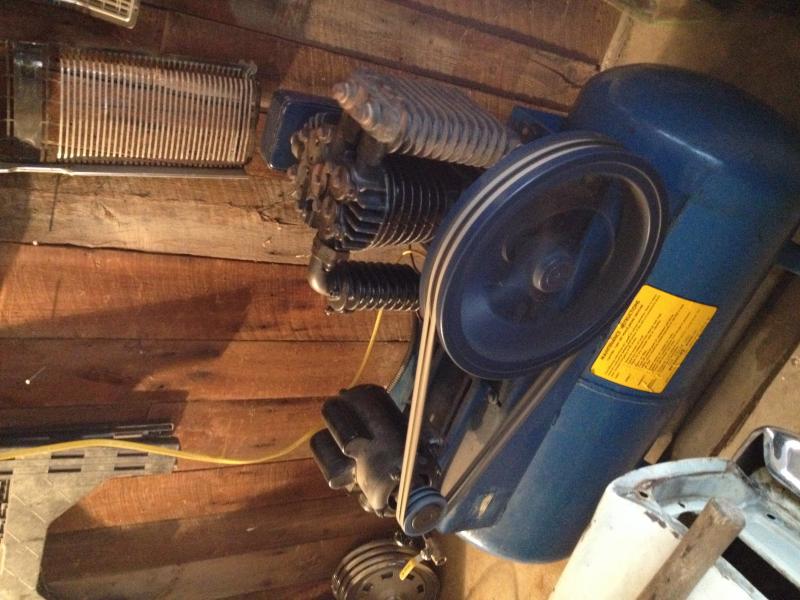

Hi all, I bought a Brunner air compressor yesterday and hooked it up 220v today. It runs great and is real quiet, I had a conversation standing next to it while it was running and neither of us had to raise our voices. The thing is, I cant find any info on it. it has a Brunner plate on the tank side and that's it. No other tags, numbers, stampings or castings anywhere. The pressure gauge at the air out end goes to 300 psi and looks like it's from the 40's or 30's. Two stage compressor, all cast iron. 5 hp Dayton motor. It needs a pressure switch diaphragm though. What I want to know is how much this thing will hold for pressure? Can I replace that original pressure switch with a new one that has the same number of outlet/inlets? How many gallons is the tank? 60...80? How old is it?

I, too, have an old Brunner. Mine's an upright. Heavy as hell. I've got my pressure switch set at 150 pounds...probably about max where you should have yours. You should be able to replace the pressure switch, just find one with the right range on it.

Got the 12x12 inch sheet of natural rubber today and cut a new diaphragm out of it. It works fine. Cuts out at 145psi and back in at 95psi. I'm going to play around with adjusting it. But all is well.
Pressure sounds good to me. Is there a label or tag on the tank itself, telling max psi? Either way, your 145 psi will do any thing you want it to do.

THERE IS NO WAY I would use that TANK without HYDRO testing which you can easily do YOURSELF
Pull the tank / compressor apart, and plug all fittings except one "at the top." It is best to prop up the tank to form "the least" cavity at your top test fitting.
Fill it completely with water. Get all air out clear to the top of your fitting. Position the tank carefully so this happens.
Then simply get "whatever" fittings you need and a pressure source that is NOT oxygen or flammable. I just use CO2. "Rig" the pressure source to the tank and pressure it up to at least 2X your operating pressure.
