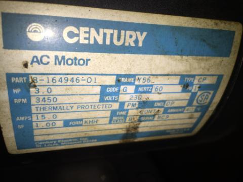

Not a giant two-stage 80 gal, but I think this Quincy is older than me and takes everything I have thrown at it...fwiw it has a Century motor.
Are the cylinders both the same size?
Hard to see in the picture.
