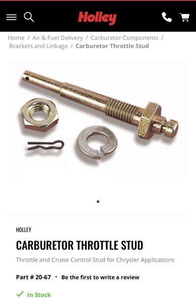

I'm giving @R413 the credit for this one, since he just suggested it in another thread. Should be the one you are looking for. Similar looking to the one Edelbrock sells for their carbs.
CARBURETOR THROTTLE LEVER EXTENSION
He’ll have to get this too, Holley’s proud of it.
