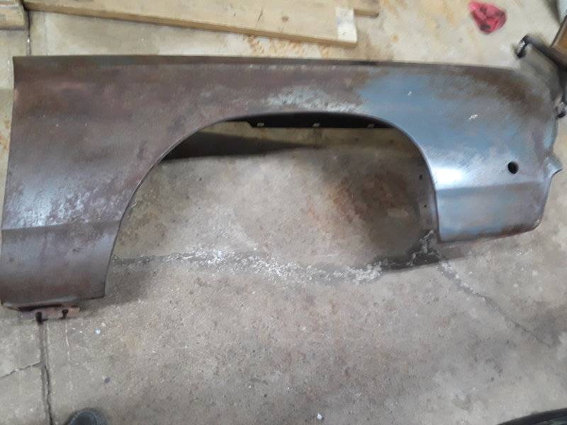

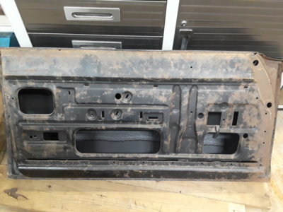

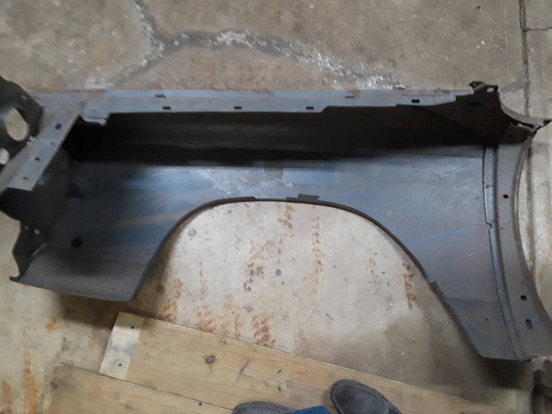

Scored NOS fender and door for my road runner at local swap meet yesterday. Got both for 475. Down side, light to some heavy surface rust. Probably will have to be blasted, unless someone has better idea. Let me know what you guys have done.

I would not recommend blasting any exterior sheetmetal......Inner frames can be blasted but be careful around the openings so you don't hit the backside of the exterior metal.....
Strip as CNC noted above.....invest in wire wheels and striping disks...

Thanks, didn't want to go redistrip route as inside door is perfect with factory sound deadener, but better then having them warped and ruined by over aggressive blaster.

Maybe a vat of evaporust?

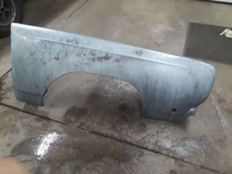

As for the rust removal, don't let anyone near them with a sandblaster. No electric tools either!
Sanding bare by hand or gently with an orbital, a hand spot blaster for pits, and metal prep acid used properly is a safe way to ensure no damage.

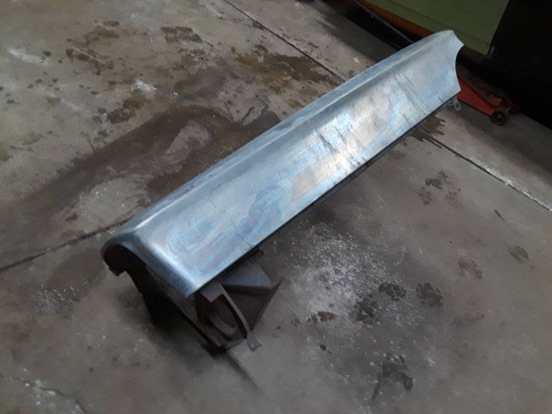

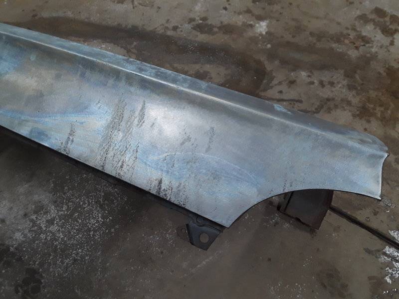

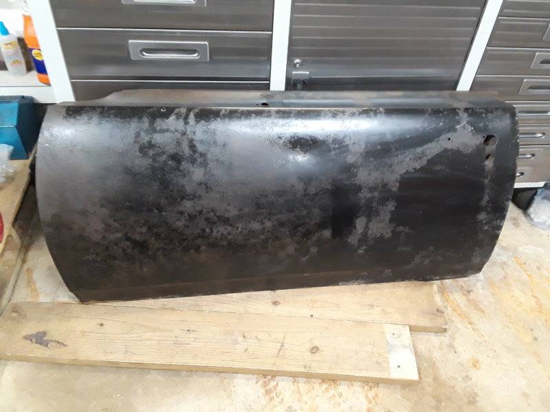

I agree, know for a fact as my Dad retired from the old Twinsburg Stamping Plant. Parts that had defects often went to the warehouse verses to the assembly line. Any fender or door NOS or otherwise require some tweaking. NOS usually a little body work to repair that factory ding or dent. I've sanded the fender, used some prep and etch and it actually looks pretty decent now. We'll see how it fits this weekend. LOL Thanks for the great comments, very accurate from my experience.
