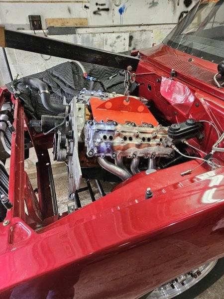

Motor ran on run stand so I put it in the car and went to a race in Florida in March.
On the track it fell flat on its face. Spent the weekend at the track rewiring and trying other things.
After a couple weeks playing with it, it seemed to run better.
Went to Island Dragway and did basically the same thing.
Spent another couple weeks trying different things with no luck.
After being completely out of options I pulled the motor.

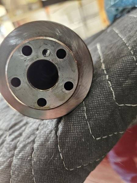

I took the front cover off , put the engine on TDC and noticed the cam phaser was substantially off target.
It had sheared the locating pin on the cam.

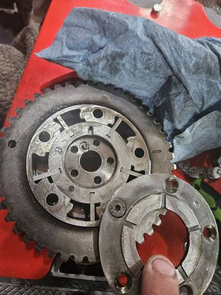

Digging further, I pulled the cam phaser apart and noticed that it wasn't locked out like it needed to be.
The phaser swings timing 18.5 degrees either way. 37° total..

After a few calls to people involved, I realized the wrong cam phaser was installed right from the beginning.
Bingo.
That was my problem from last year as well.

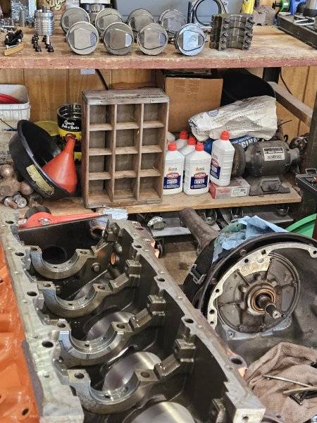

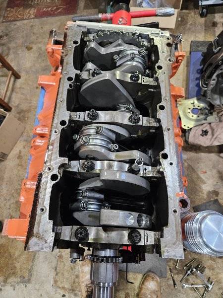

At this point I decided to check everything myself on the motor. I found more ...
All the arrows on the main caps were pointing backwards. Wrong way!
I don't know if he line honed with caps backwards or if they were put on that way afterwards or if it even matters.
So I tore the whole motor apart and am dropping the block off at Alan Prusienski's shop.
I'll be assembling everything myself this time.
