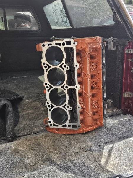

I need to get my block to a shop right now.. this is the only time i miss not having a truck.. everything is fine til you need oneYeah, I had a good shop in Ohio that had a new hand come in and they screwed up my valve job and other things with a completely new build. In fairness and respect to the shop owners and family, I declined their offers to make it right. That head guy was fired shortly thereafter. The shop was just too far away from me to go back and forth, so I bailed. They had a good reputation though in the race scene in Ohio.

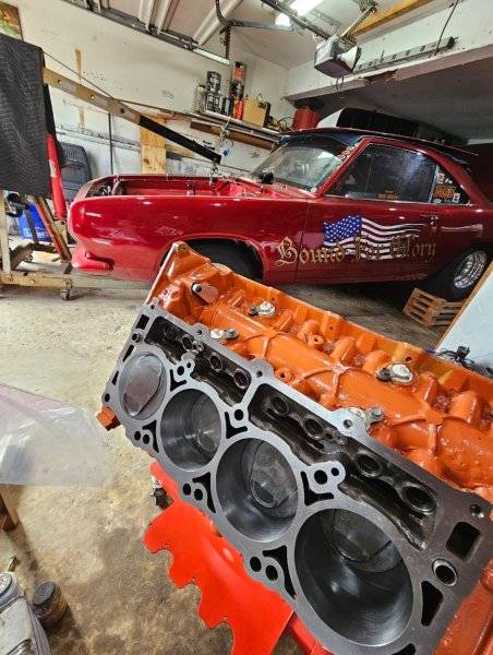

wow you got that back fast.Dropped off my block on Saturday and picked it up today.
Looks great.
Honed cylinders
Line honed
Decked
Polished crank.

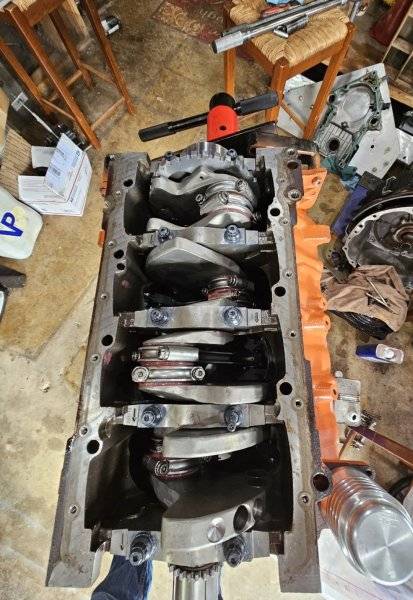

Just waiting on my cam. Going to wash ,check and assemble bottom end while waiting on the cam.
He said they weren't horrible but they were off.So what happened with the main caps.
Doug
I wonder if they got honed the proper way then installed backwards...He said they weren't horrible but they were off.
Not if they were redone.I wonder if they got honed the proper way then installed backwards...
That's the answer I was looking for and didn't get, so I had it redoneI wonder if they got honed the proper way then installed backwards...
yeah, at the end of the day as long as it's corrected that's all that matters.That's the answer I was looking for and didn't get, so I had it redone
Did he turn them around?He said they weren't horrible but they were off.
Yes, they're pointing forwardDid he turn them around?
Doug
Pointing forward now.I think the question being asked is……..
Which way are the arrows on the caps pointing now?

Block washed, crank and mains back in pointing forward, rods and pistons back in...
