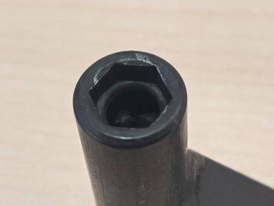

Just picked up this nifty tool to aid in bleeding brakes that I found online. It has an O-ring on the inside, so theoretically, it snaps over the bleeder and the fluid would pass straight through it and out the tube with no mess. This one is for 5/16" hex......

Let us know how it works, I like the idea.
The problem with that is most of the aftermarket wheel cylinders and calipers have various size bleeders on them. I have found none to be consistent.
I have found that the aftermarket (drum) wheel cylinders are 8mm.
I have bought 2 rear wheel cylinders from the same Oreillys store and both had different sized fittings. No standards in the aftermarket I guess.
