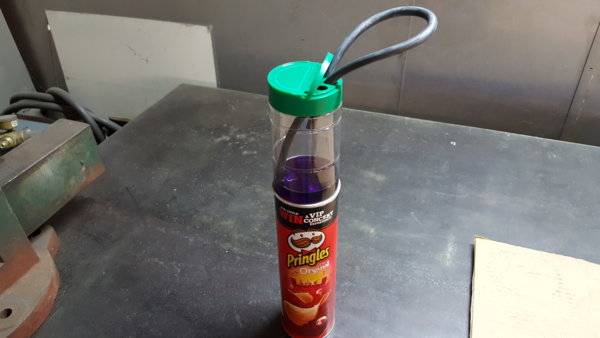

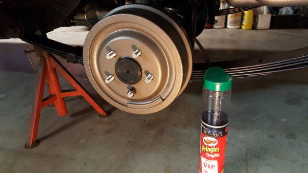

I like to bleed into a sealed bottle. Doing it by myself I have a hose from the bleeder into the bottle and the hose is submerged in fluid. When you let off the brake it won't draw air back in. I don't have much faith in the vacuum bleeders.

I have a pressurized bleed system that is fine on modern MCs but not very good on the old cast iron ones. I also have a vacuum pump that does great to get the initial air out, but won't get the very small molecules out like Yatzee stated, sometimes they will be so small that the fluid will look milky, so I resort to the same method that KKid uses. A bottle filled with fluid, a hose that fits tight on the bleeder and is submerged in the fluid. Make sure the hose is as short as possible, the longer it is the more air you have to push out initially.
Also remember to bench bleed the master first - do it slow for longer than you think , Teflon tape has to go .bleed into bottle always has worked while the wife worked the pedal slow .

My personal bleeding trick is to use a length of clear tubing with a one way valve spliced in. The other end of the tube tightly into a water bottle. Wrap a wire around the tubing to suspend it above the bleed screw. Air goes up, valve keeps it from going back down and fluid runs to the bottle. I use it by myself all the time.
