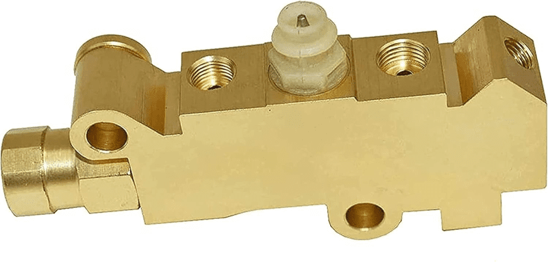

This seems to have solved the problem so far.Are all the bleeder screws at the highest point on the calipers?
If not you will never get all the air out.
Thank you very much. I never would have thought of this.
