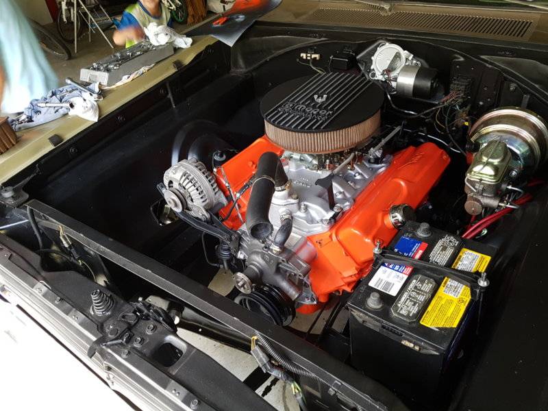

What did you do for a master cylinder 66 sat I have a 66 sat with a 440 with only 7 in of vacuum and I have a disc brake kit but don't have much for brakes with the original power booster ,going to go with a 15/16 manual disc drum master cylinder is that what you did
I don't know what size the master cylinder is sorry - it all came with the kit. It's nothing fancy - as per the photo - but it works really well. I actually never worry about if I'm going to stop which is a revelation for
me in a car this old.
