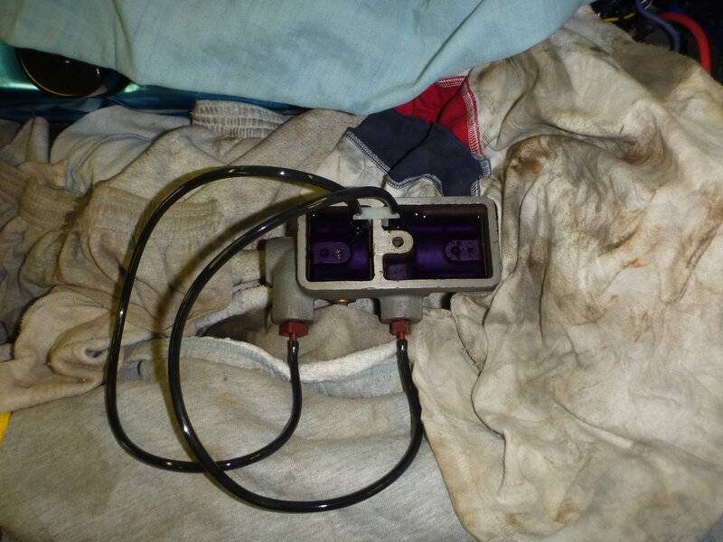

If the MC was emptied it must be bench bled. But that doesn’t need to be on a bench to do it. It means running the output tubes back into the reservoirs and bleeding to remove all air bubbles, then connect the lines and bleed at the wheels. All 4 wheels.
