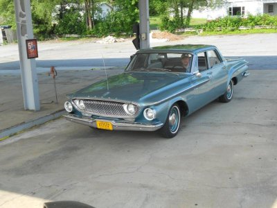

I'm looking for opinions on if stainless steel hard brake lines are a good idea or not on a car that is over 95% original. I am trying to keep this car as close as I can to original so would standard steel lines be the best? I am only looking at the SS hard lines as a rust preventative measure, nothing else. Opinions welcomed; tnx!
BTW, car is 1962 Dart, plain-jane 4Dr, /6, 3-on-tree....I just liek the idea of preserving a few of these are they really were.

Good comment on the SS and hardness; I was wondering on the SS flares and just getting them seated on the wheel cylinders might be a challenge if they were not perfect. So, OK, regular steel it is.
And the why as to replace them? Just being cautious; this car sat in a garage undriven for almost 20 years from '72 to '90 or '91, and has been only driven 3k miles since then. SO, I am kinda thinking that these could have gotten moisture in them pretty easily in that time. The brake have had attention (the rubber lines have been repalced), but it is time to go through the whole car; the PO (2nd owner) took good care of it but is not mechical.

Nice looking 4dr! Keeping it original is a good thing. Love those '62s!
Yep, the MC will become dual which is the only change I plan for the car. All wheel cylinders, shoes, etc. will be worked over and/or changed out for new. The PO kept meticulous records for the 27 years he owned it, but the work was done just now and then, so time to go through it all.
