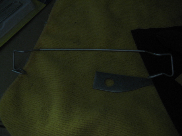

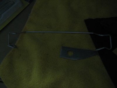

The Pads from Rock Auto fit The part no PDM 39 Raybestos set. I recieved a anti rattle spring when I got my calipers back . I cant figure out the right way to mount this thing Do I even need it? mobileparts what are you asking for on the brake pads. Thanks

I am having the same issue, Coronet 14...I have spent hours searching for pix of an installed caliper with this replacement clip, spring or whatever its actual name is, with no result. I am installing brakes on my 1970 Charger R/T and am currently waiting on a return call from A1 Cardone (bought replacement single-piston calipers from them), they seem to be willing to help but their engineering department had a tree fall over their power line so it may take a few days....have you had any luck in the meantime figuring it out?

I found an excellent picture of how the anti-rattle clip fits on the caliper, immediately lost it after not saving it to my favorites...dumb,dumb,dumb...anyway I have that small issue solved. It would seem that the new calipers still require using the old 'positioner' clips, which are of course brittle and squished from years of use, so I will spend some time on the RamMan's site and see what he can do to help.
If anyone needs help with the brake pad ant-rattle clip placement, I can at least provide a pic of mine (clip installed, now waiting to find the rest of the parts to complete the caliper change).

I Left the anti rattle clip off. The Calipers didn't have them since I had the car. If they squeak I will get some stuff to put on pads. I had to send my master cyl back to Ram Man. Waiting to hear back on why the piston jammed
