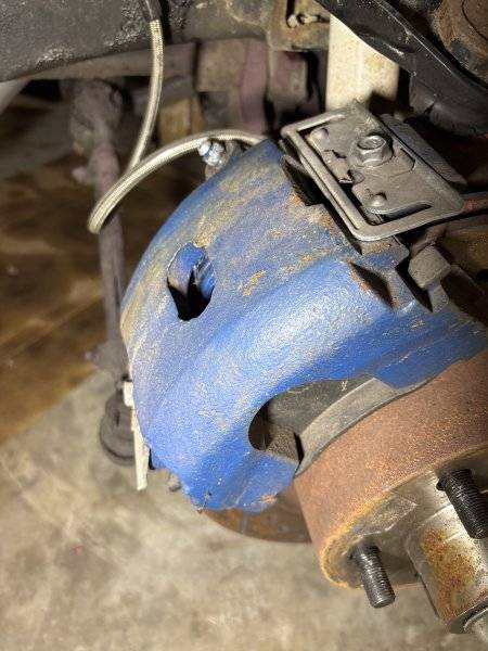

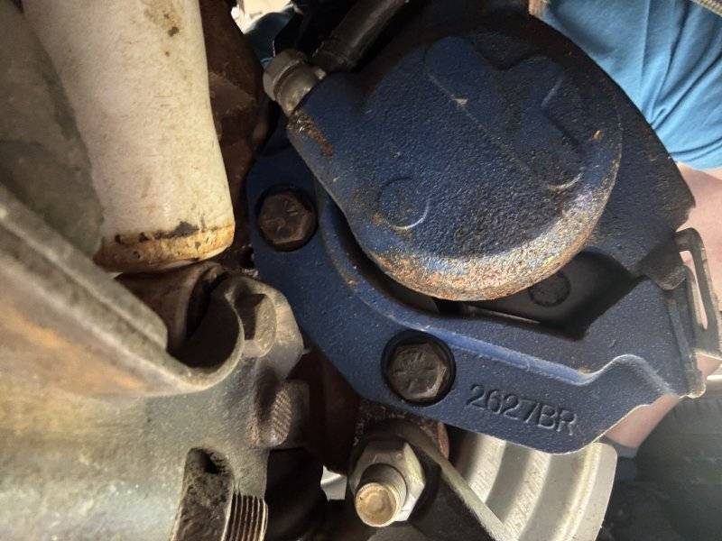

My 65 Coronet came with a generic disc brake kit installed long before I owned.
Have a sticking caliper now and am trying to find a pair. This part # doesn’t show on Rock Auto. I am a GM guy doing my first Mopar so not familiar with calipers. Are these A or E body?
I cannot take credit for blue paint
Dan
73- A body, F body and some others without the pin type caliper which uses a D39 pad. Yours uses, like mine, the D84 pad. The D39/84 are industry numbers for pad style. When you get one, make sure the piston diameter matches yours. Don't want different sizes side to side. E body uses the D39's. Have you tried cleaning off the sliding surfaces and lubing with a very small amount of brake caliper spec grease or anti seize? Maybe there is a burr holding up the works?
Mine started doing this. Just unbolted them, wire brushed the sliding surfaces, a tiny bit of silicone brake grease, and bolt back together. Problem solved.
Another good test is trying and push them back with a c clamp. Compare the difficulty in turning the clamp.

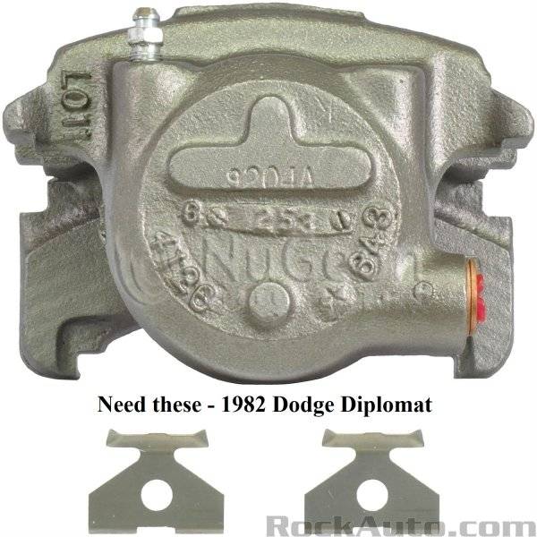

I have the same calipers in my 67 Charger. I had replace them as the seals were all dry and rotted from sitting for years. I has to use calipers from a 1979 Dodge Aspen. I ordered one from a v8 car and they fit fine.
Are they any better than the 79 Aspen calipers? Maybe I can try them next time I need to replace the calipers.
I don't know how they'd be "better" - what are you expecting to be "better" ?!?!?! It's all about how they fit - where the hose attaches and where the bleeder is - there is no "better".
One thing you do have to take a good look at with these reman calipers (they're ALL remans these days) is the bleeder screws and seats. I had FIVE calipers with bad screws and seats before I finally gave up and bought a pair of bleeders and refaced the seats myself (with a drill bit and my drill press I might add!).
Also, some will have phenolic pistons as opposed to steel. I guess there's a difference but it seems to be based more on which style they are as opposed to who makes them.
Honestly, just buy the cheapest one's you can find !!

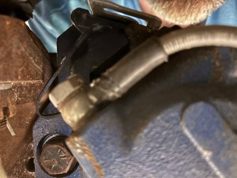

I say better in that sometimes improvements are made, but I guess it's probably the same part. I just worry about those clips they used to hole the caliper in. Seems to me pins are better.
Oh I get it ... you're one of those guys that wears a belt AND suspenders, right ?!?!?!
There are or were hundreds of thousands of cars on the road with calipers held on by those clips. Get over it !!
