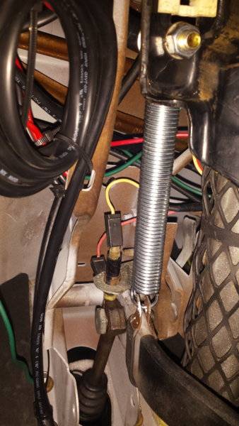

I added a spring to my setup as my pedal didn't always return to the stop (front disc conversion, non stock MC). It doesn't interfere with function and it works.
View attachment 673256 View attachment 673257
Nice set up
