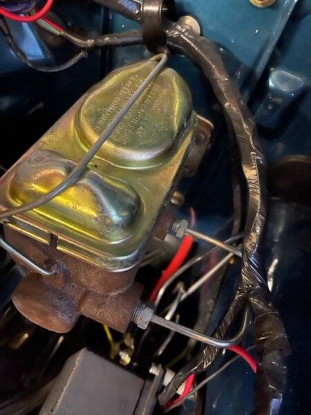

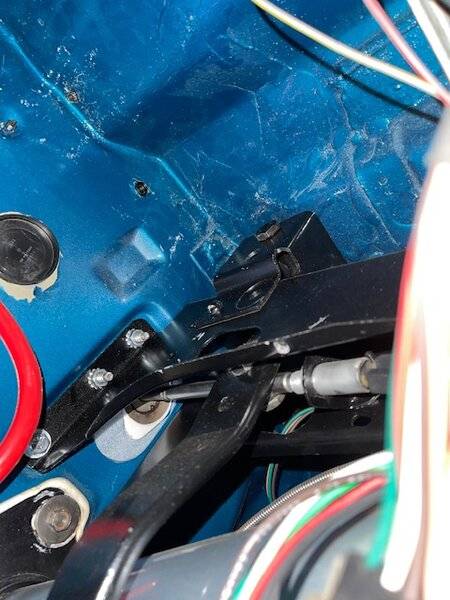

A pic of the master cylinder height would help.

Thanks for all the replies. Since the car was originally a 6 cyl with manual brakes and was changed to an automatic, I don’t know if the bracket that holds the brake pedal came out of a manual brake car or a power brake car. I think I’m going to explore the master cylinder and if it is bigger than 1+ inches, I’ll try a smaller one. Changing the brake pedal ratio looks to be a job I’ll try to avoid.

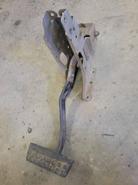

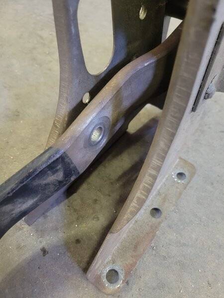

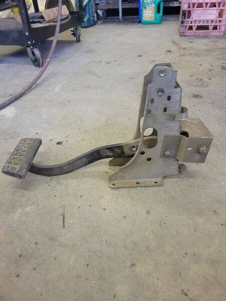

I just stumbled upon my old power assembly from my 64, when I converted to manual..

I just stumbled upon my old power assembly from my 64, when I converted to manual..View attachment 1266254View attachment 1266255View attachment 1266256
That's the same bracket that I have in my 64' currently and need to change out to the manual style one. You mentioned that the master cylinder uses different installed heights between the two different styles?. Do you have a picture of yours installed, it might help clear up some things for me ( and others reading this) thanks @RemCharger
That's the same bracket that I have in my 64' currently and need to change out to the manual style one. You mentioned that the master cylinder uses different installed heights between the two different styles?. Do you have a picture of yours installed, it might help clear up some things for me ( and others reading this) thanks RemCharger
