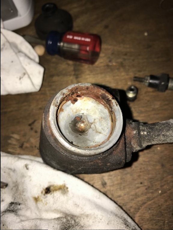

Found it. Wheel cylinder is frozen solid! The good news: brake shoes and drums look like new. Gonna buy 4 cylinders and 2 new hoses tomorrow.

I suggest that you switch to DOT 5 silicon based fluid. It will eliminate rust and corrosion that you show. The corrosion is due to the DOT 3 fluid absorbing moisture from the air. DOT 3 is hydroscopic...which means it has an affinity for moisture which will ultimately wind up in the lowest point in the system...the wheel cylinders. Many years ago, i converted my RS23V0A****** car to DOT 5 fluid then changed all components including hoses and the master cylinder after first flushing out the lines. I have not had a problem since.....
